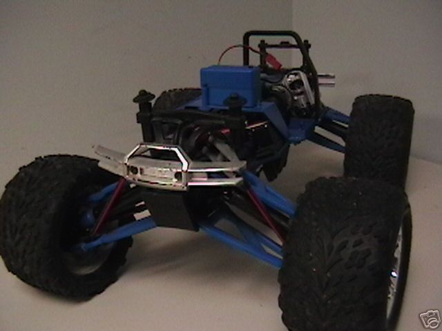

The E-Revo chassis is installed and I still have the E-maxx motor plate on the tranny so the motors are mounted pretty far forward. I tried to counteract that a little by sliding the batteries all the way back in the boxes, still a little front heavy, but turns great. Wheelies are definitely less abundant with the low CG batteries and extra wheelbase. It just spins the tires on the street. Looks awkward with the old 2.5 body on there
