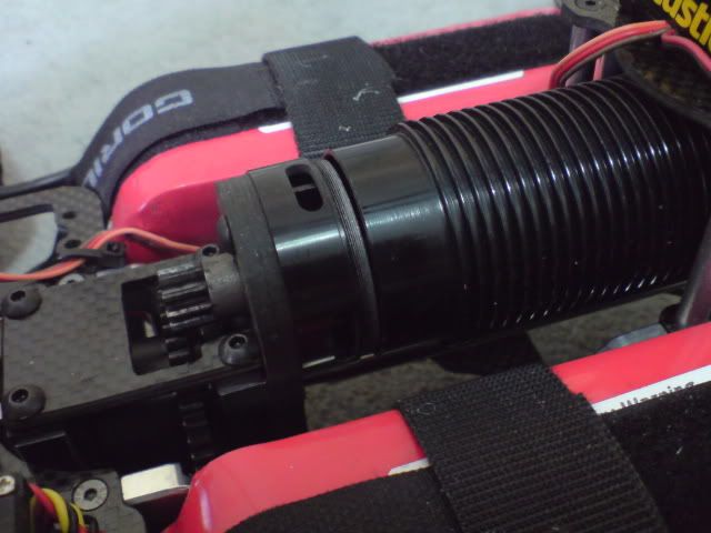

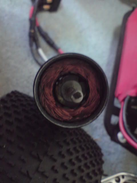

Heres the weird thing, the front cover on the motor came off. It must have been rattled loose or something. I think the internals are ok because i stopped running straight away when it slowed down and made a crunching sound. Im just going to loctite it back and keep running it. It must not have been properly secured at the factory or something. My motor mount is real solid, the fron part was still really tight. Should i keep running it, or contact Neu and see what they say?

Since it's not a cheap motor, IMO it would be wise to contact NEU and get their opinion.

I agree. Call Neu and let them know what happened.

Me to man. Considering what these things cost, and the fact that it fell apart I would be calling them right away before you even try to run it again. The thing is this. If you contact them, and get their approval to run it, then it is on them. If you run it again and run into a problem it becomes your fault for not contacting them straight away. So do the smart thing and shoot them an email or give them a call either way your covered. Just my opinon from experience.

Im gonna take a wild guess and say the lack of rear support (the strap stops the motor flexing upwards, but not downwards) is the main problem- that motor is huge and long, so some form of rear brace is really needed, along with a better secured front end...

You need to make a rear motor support or some kind of system that will hold the front and rear of the motor together like the rc-monster heat sink does. That motor is just too heavy and the load the front of it has to cope with is just too much.
Edit: The following picture is from http://www.bomb-proofproducts.com/home.htm as an example of a clamping system.

sorry for the late reply, been real busy with chrissy, work etc... Well, the truck isnt running, i found the endbell didnt actually unscrew, the threads stripped, so ive sent the motor back to Neu for repair, not sure how long that will take but ive requested it to come back a smooth can 1527 with no fan.
