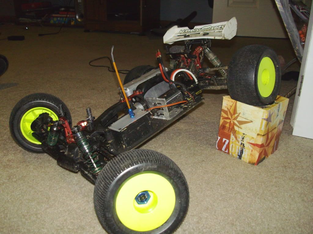

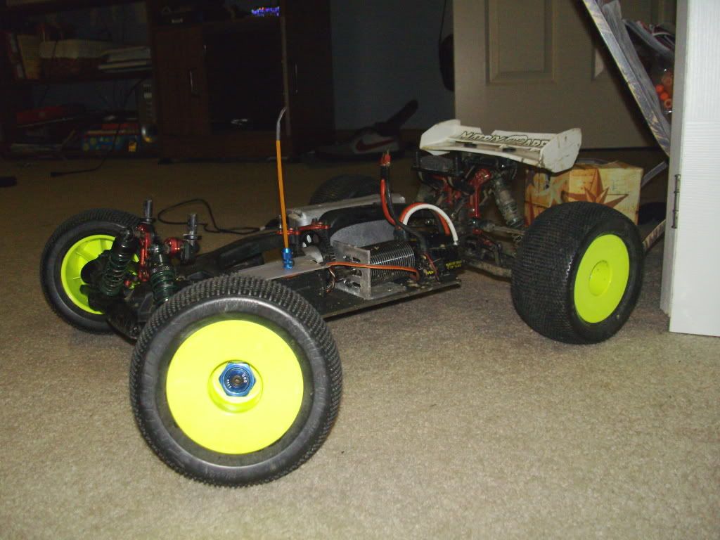

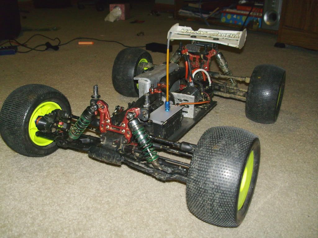

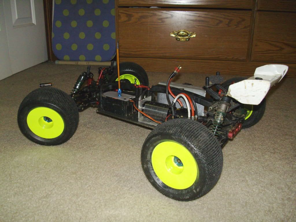

Originally Posted by Krawlin View Post
nice pics Ben!
Just wondering, but why don't you have the motor on the right side of the chassis and the battery on the left like most other conversions? Just seems like it would be a better setup, more room for the battery.
erm, cuz the original mount was on the left side of the chassis and i never had a reason to move it, and my battery placement is a whole lot closer to the centerline as is compared to it being outside the spur.
11.24.2008, 11:44 PM
You really should shrink those motor bullet connectors, you're begging for a massive short, then death of another v3 MMM.
