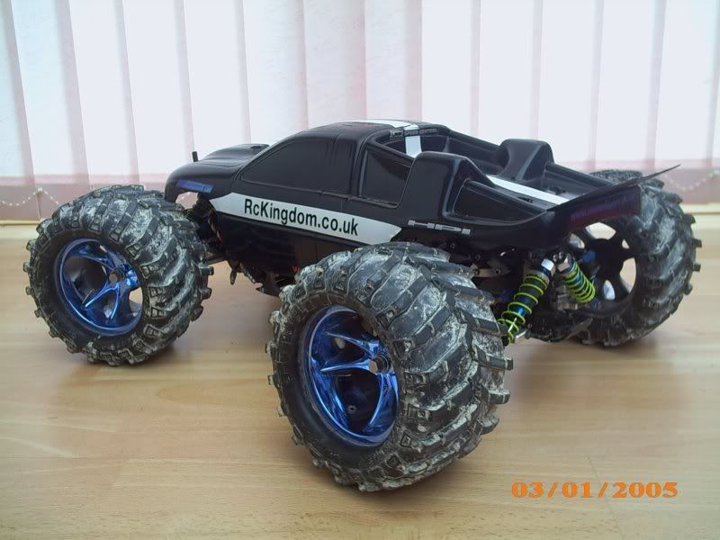

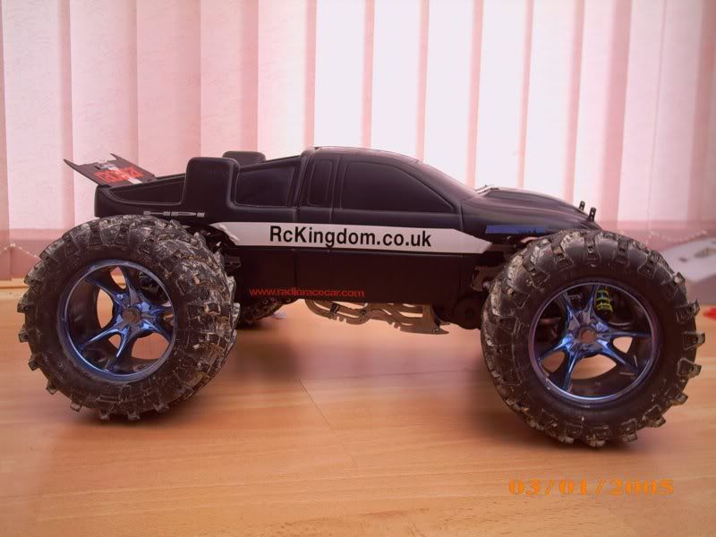

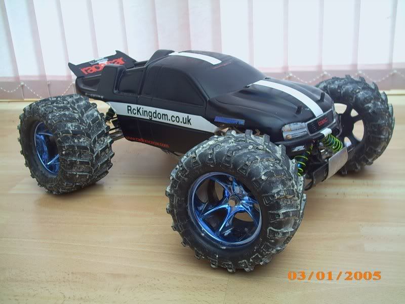

Here's some newer pics with the bodyshell on:
As far as a brushless system goes, well I'm still a little unsure. The main limitation is that because of the gearbox casing's design, I'm limited to motors with a normal 540 diameter. Also There's no way I can afford the Lehners unfortunately, which was why I was looking at the Feigaos. If running the two 16S Feigaos on 16 cells is a little too powerful, I can always bring it down to 14. That setup, with the two Warriors, looks like the cheapest reliable option, what do you all think? Thanks for your suggestions though, and thanks for your comments. :D
There's still a little way to go before she's 100% ready for brushless (still gotta get those CVD's, gonna change the shocks to OFNA Ultra LX Comp Fronts, and a few other things)...this is taking a long time, lol! Hopefully it'll be worth it in the end.
