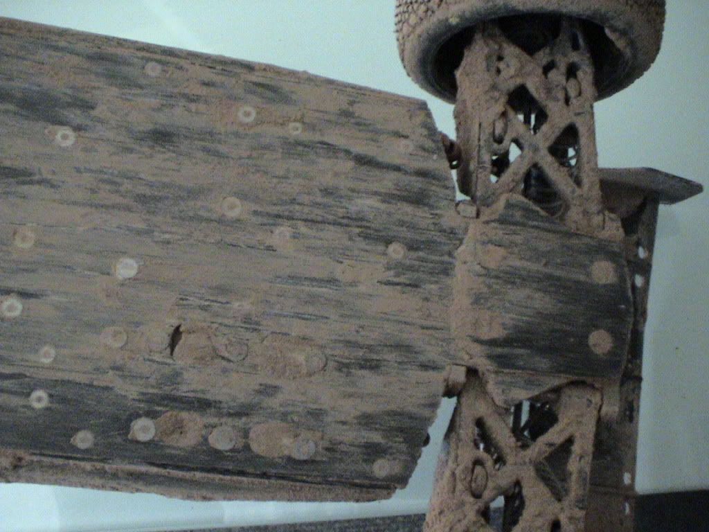

Read the whole thread- he heated up the front end and formed the kickup, then let it set at that angle. He is also working on getting the CF laid onto a mould to pre-form the angle, rathe than doing it retrospectively.
Just bolting the parts in place will cause the front end to naturally curve, but this isnt ideal as it stresses the CF and makes it more likely to snap. Measuring the stock chassis to get the required angle, then laying the CF on a wooden mould and hitting it with a heatgun should give it the correct shape in the correct place.

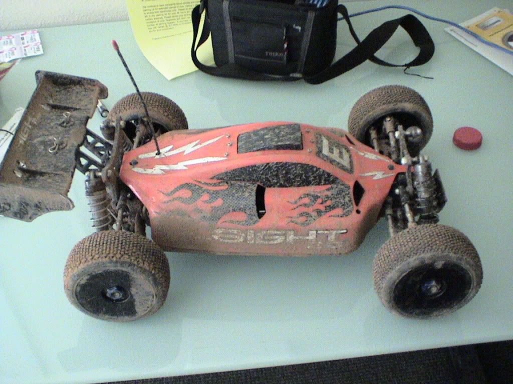

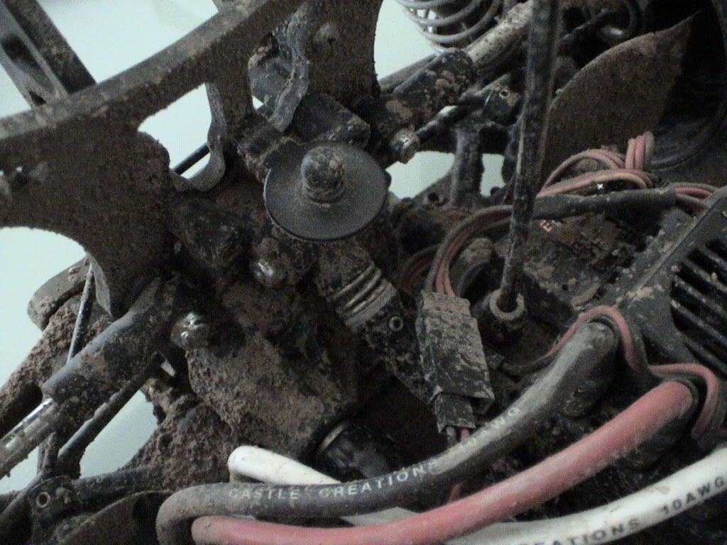

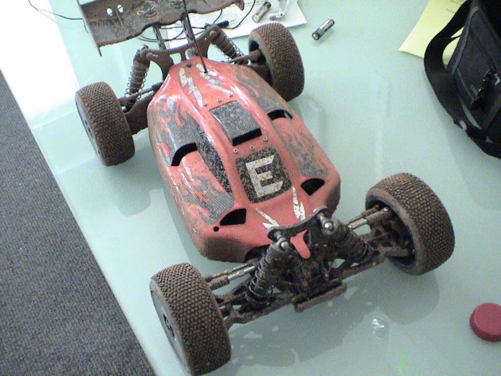

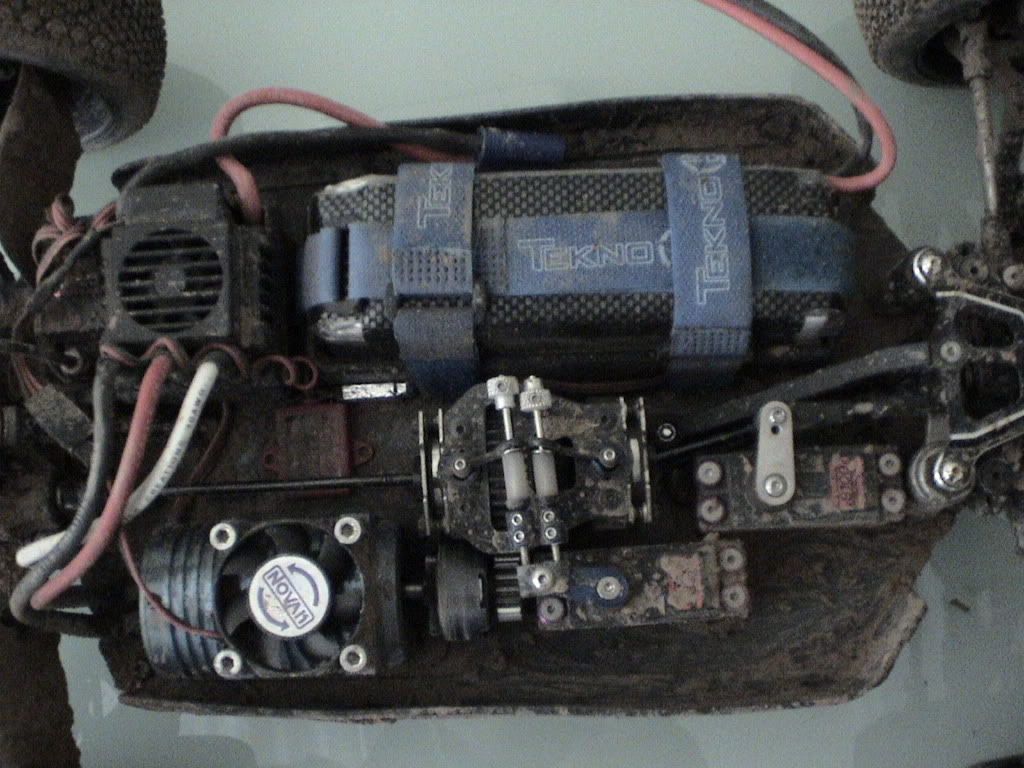

here are some pics of the 8ight now after a couple of weekends at the track. we have had a lot of rain this month so the track has been muddy. i used to hate to get my cars all dirty after putting so much time and money into building a sweet rig. now i dont care. but it is kind of a bitch cleaning them every so often. i like to build them but not really like to maintain them.
