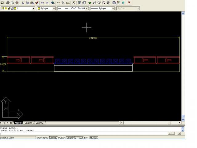

Here is a side view drawing. The Blue are the resistors. I used 2 fans on each end you didn't have a CFM listed for the fans but I see a range from 12 to 60 cfm. I can do it with just 1 fan on each end or as many as you want. Don't know if you know but fans in series increase pressure, while fans in parallel increase flow (not electrically, but the movment of air).
Jeff
