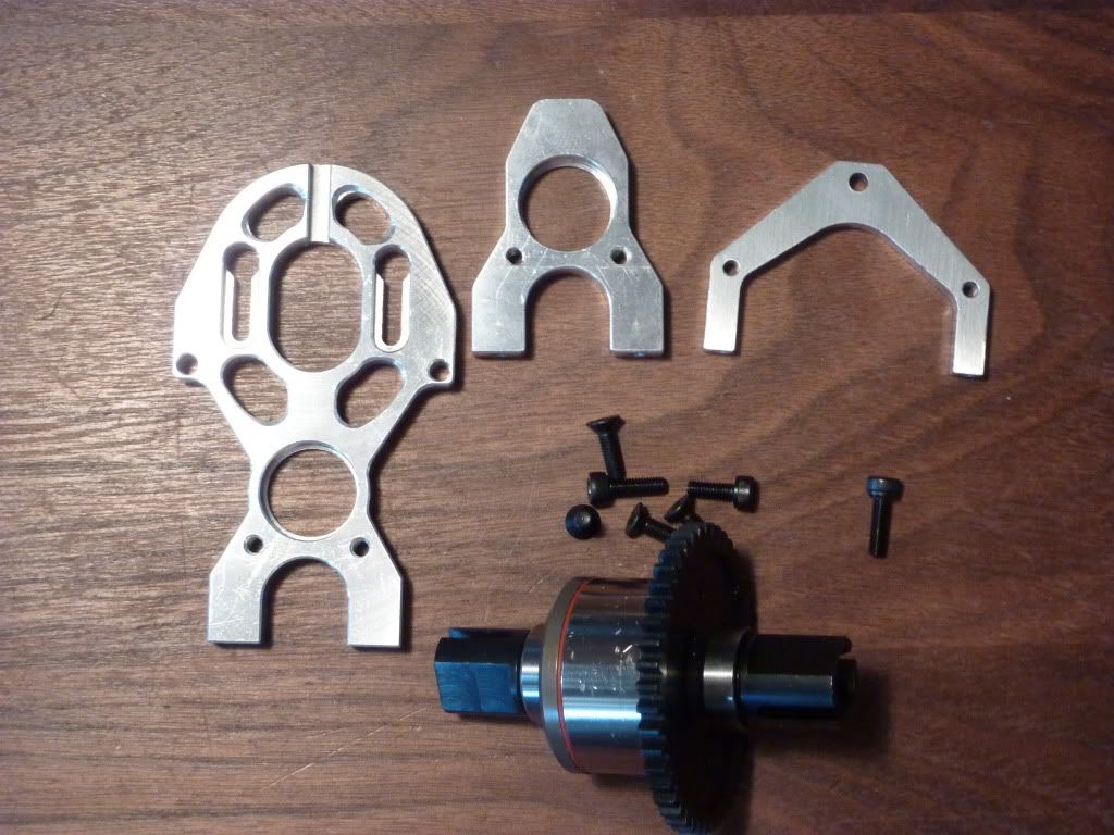

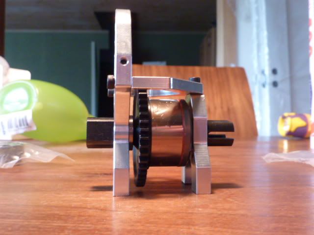

Originally Posted by G-revoRickard View Post
Hi
you helped me befor with centershaft questions when i use a CD. I cant find the link
i wonder if you know what shafts that fit a FLM chassi whit a CD.
Thanks
Hmmm... Here are a few steps you can use to find the required shafts:
- assemble the motor/CD mount making sure it's a nice and snug fit for both CD bearings (very little play as possible). If shimming does not help to make a tight fit,
you'll have to modify the upper plate of the universal mount by drilling a second hole to move the front vertical closer to the CD
- mark and drill holes on the CD mounting plate (use the gearbox skid plate already mounted on your truck)
- with a 52 tooth spur, you will need to remove some material from the upper plate of the chassis for it to fit
- install the assembled unit and make sure the spur has enough clearance...
- with the unit installed, you can go ahead and measure the distance between the diff output cups to find out what shaft lengths are required
- compare the measurements with current shafts on the market... if you can't find a match for your specs... shoot Mike mail and see if he can help you with some custom cuts
A second hole drilled in the middle of third piece from the left might be required to have the CD fit well
Rear bearing not sitting in the rear bearing seat fully
The gearbox skid plate seen here will work for you CD mounting plate if you don't already have one
They are quite few members using the universal mount in their rides... maybe you can do some reading and see other techniques/methods of getting them mounted up...
you can start here: Hey Monster Mike: Maxx CD
Alien
