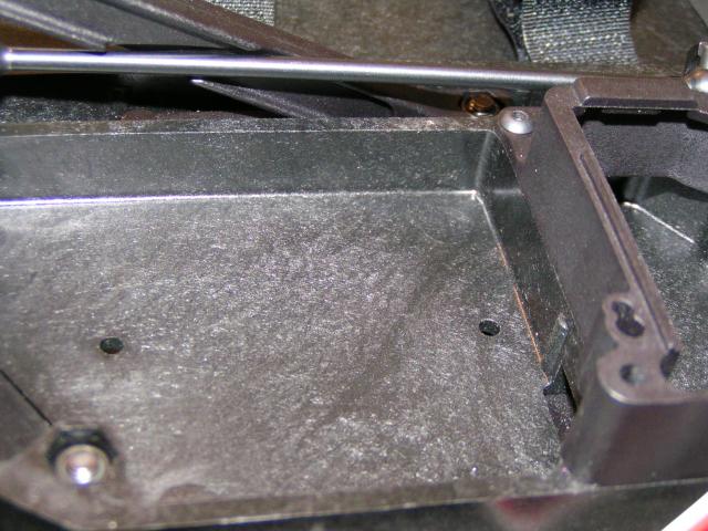

What size is the battery compartment? What is the useable size (IE, you could always get rid of the battery strap locators)?

140mm x 49mm for batt tray, and esc area has room for a MMM with a little space all around

Thanks. Is that up to the battery strap locators, or including/over them?

It is to the edge of the straps/holder as well as to a part of the chassis that holds a nut in place. See the spot for the nut to the right of the straps in the pic.
