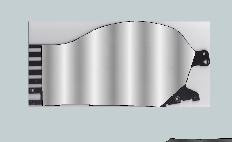

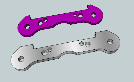

I had to put the centre diff and motor relocation on hold just for an extremely short while. I cannot use my existing TVPs as the 4mm alloy plates are causing problems while mounting.
I have chopped and drilled to many holes in my TVPs that they seem a little weaker.
I got two side plates made up which will go over the existing tvps...
They will be anodised in black so you should hardly notice them. And considering the lipo boxes cover them basically, they will not really be noticed.
Having these new plates, means i can now remount all my internals exactly how i want them and wont be limited to where i am available to mount them.

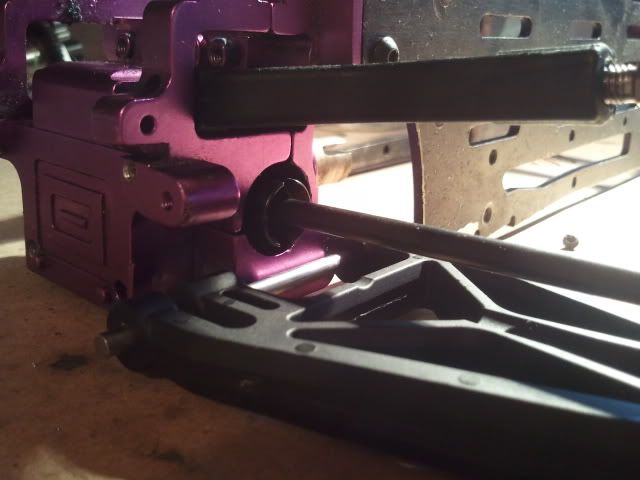

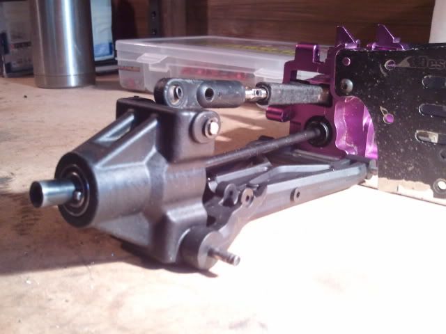

In order to get the lst hubs to fit the savage arms, only minor sanding of the hubs were required luckily!
To get the CVDs to work with the diff... i am using vorza diff axles
some pictures of me mocking up the hubs...

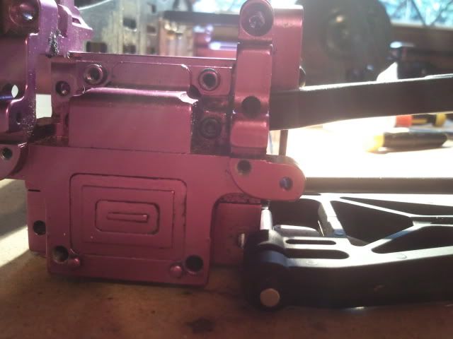

Note where the hinge pin is in the pic below
The hinge pin needs to sit as close to the bulk as possible to allow correct distance for CVD to work
I measured this to 6.5mm wider than stock
Increased width over stock
