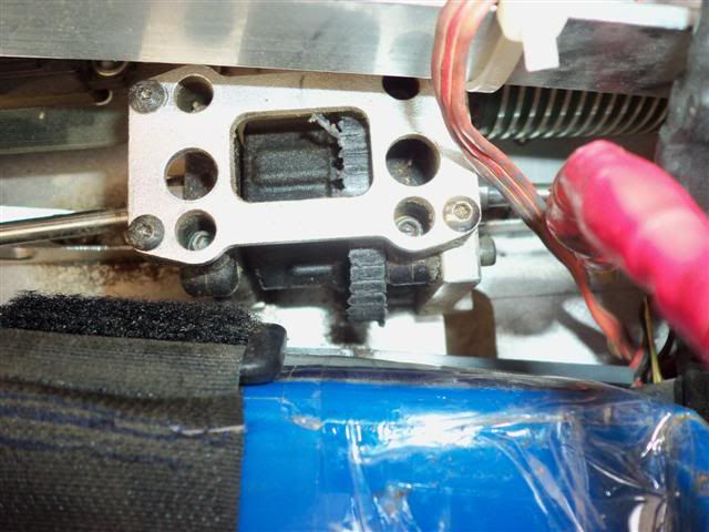

A new pinion arrived yesterday, and i had 20 mins, so i knew i wasnt going to finish the installation... BUT i went as far as removing the centre diff to install the pinion...
WHAT DID I FIND?
The pinion was absolutely fine!!! The mesh was just completely thrown out, i guess i didnt torque the bolts down enough and even with loc tight, it still managed to move.
At least my novak pinion is absolutely fine. And i have 2 spares now just in case...

I KNOW JOE!!!! but i wouldnt of had time to get the truck ready in time anyway...
I could have just taken the batter box off and looked in through the side, or just taken the BEC tray off and looked in, but i have never had a mesh go bad on me so i naturally thought it was a pinion!
