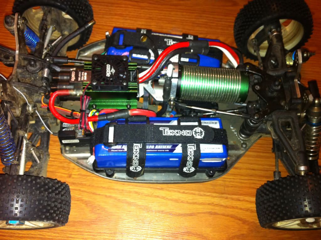

12:45 am, it's installed and I'm tired :-)
I'll get a video up tomorrow after a few hours sleep and a whole day of work...
(I've never experienced the 8S spark before, I had to plug it in twice LOL)
And yes, it all tucks nicely under the body :-)

Oh wow, nice work! Definitely is a tight fit in there but that thing will be a monster I'm sure! And that spark will surprise you first time you plug it in, but I think it's pretty harmless?

Oh yah, thought I should also mention that the Castle 8 gauge wire on the XL fits very nicely into the 6.5mm castle bullets. I did have to grind out a few thousandths from the connectors when I built my Turnigy packs though, and they also use 8 gauge wire, but apparently there's an allowable standard of variation within the "gauge" ;-)
I'll write up a review of first impressions today after a little runtime...

wow...that looks wicked!
