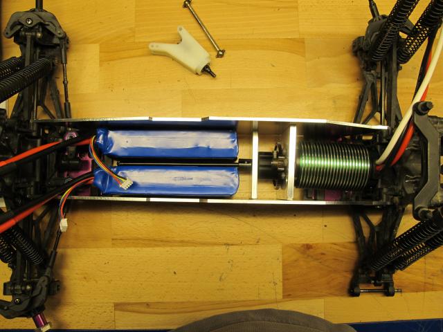

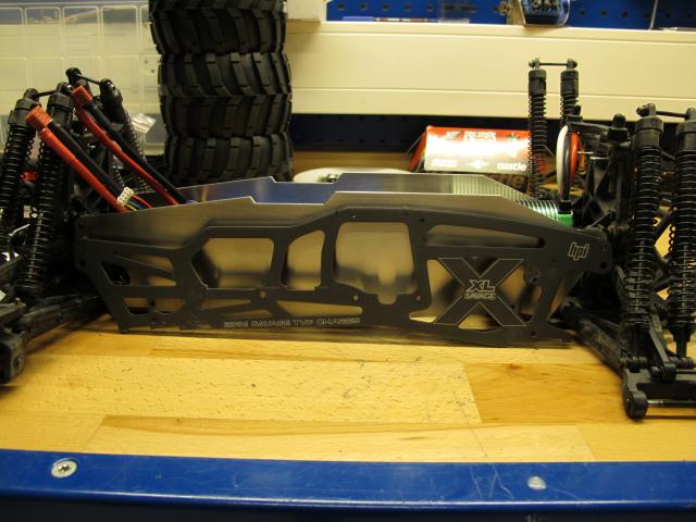

Motor mount under way... still need some support between the two parts :)
Alza racing delivers:
Hmm... with a skid plate and some sort of dogbone protection the batteries could be squeezed in between the TVPs. Motor mount was made with a centered 1717 since this allow me to push it further back.
On the other hand... a wide skidplate and a cut out in the bottom of the TVPs = batteries mounted low and horizontal:

Where will the steering servo go with the batteries up front?
Interesting idea about the cutout in the bottom of the TVPs. If the batteries were up front they shouldn't cop much abuse there. I've been toying with the idea of mounting a battery sideways above the center driveshaft. Could move it back and forth to tune the balance as there would be plenty of space.

03.22.2011, 05:21 AM
With the batteries "inside" I'd have to make a cut out in one of the TVPs, flip the steering arm 180° and mount the servo on the outside.
Its safe to say im leaning more towards the cut out approach... especially after I got the solid TVPs from Alza :)

very nice!!! im happy to see that dejan at alza is getting more custom now!
Interested to see how this turns out...
IMO i would like to see you widen the internals of the chassis, and fit the lipos either side of the rear shaft.
I like the idea of moving the steering to the outside too!
Are you going to make the necessary cut outs yourself?

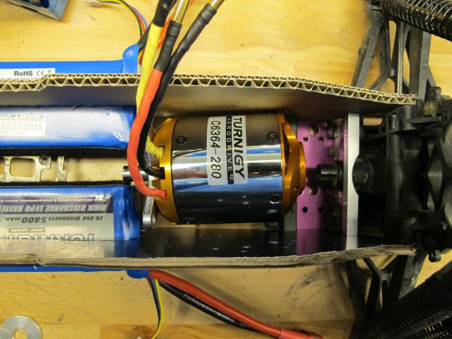

Because this is the stuff we need to fit into the construction:
The fat outrunner:
9 LiPo cells (its not the packs we'll use but you get the idea):
Its slightly crowded at the backend where I have CD and 1717:
We'll most likely have to do a cut out in the "bulkhead plate" otherwise the angle between the drive cups will be extreme... more fun challenges :)

I was planning on doing my 5T plates with the batteries cut out in a similiar fashion. My biggest concern was protecting the batteries from damage on the sides.
As for the 1cm... if you have a bottom plate that ties together the sides underneath the batteries, that should make up for any weakness in the TVP itself.

That's a darn big motor.

03.23.2011, 10:40 PM
firstly i love the lipo placement... im sure you can come up with a way to protect them!!!
You are going from an already overkill 1717 to an out runner? what sort of specs is it? kv? max rpm or lipo cells? It is HUGE! will you need a new centre diff setup?
