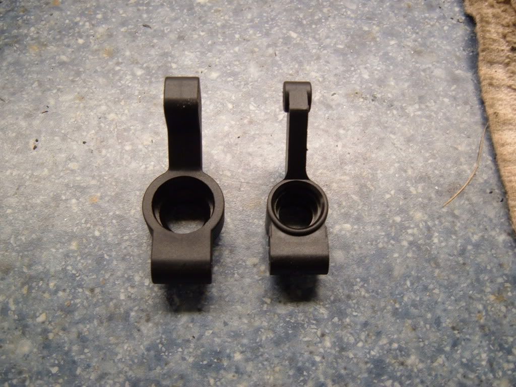

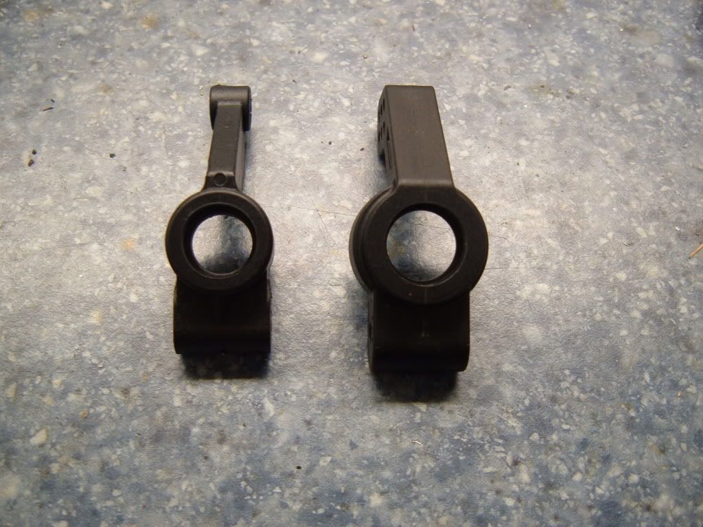

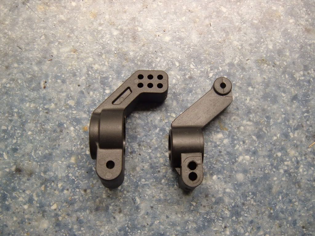

Here are some pics of the tekno carrier vs the stocker:
Waiting on inner bearings and this project should be done. About time, huh...

WOW, hadn't realized how Deisel the Tekno carriers were !
I will be buying a set for my Stampy rather than mucking with the PE parts or trying somthing else..
03.04.2011, 02:31 PM
I was very impressed. After seeing them I decided they were a much better idea than fooling with the stock carriers. I figured a few comparison pics would help others decide!

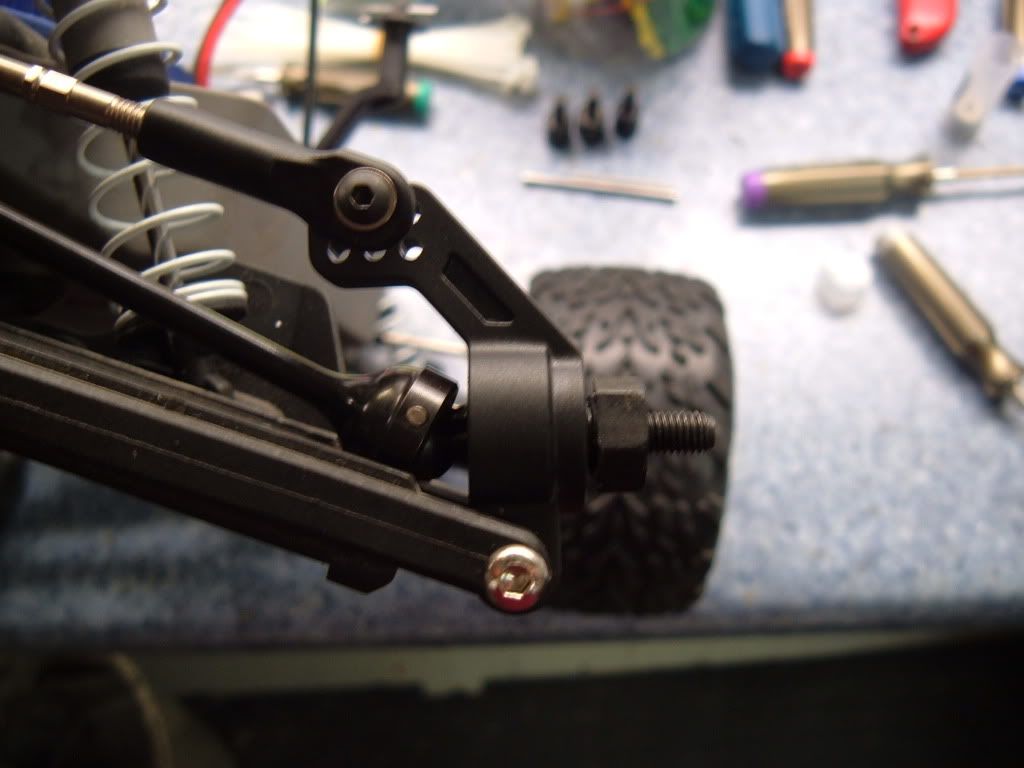

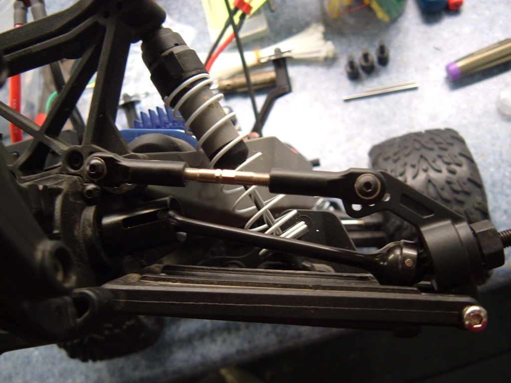

Here are a few pics with everything installed.
The 6x15x5 bearings fit the carrier perfectly and require 3 of the the traxxas 6mm id teflon washers to space the tmaxx axle. I put 2 on the inside of the axle and 1 on the outside.
The hpi dogbone and long cvd cup work, would be nice to have a 73-74mm long shaft and use a med length cup but this is the best I can do with off the shelf parts.
Will get the other side done and post up some results.
