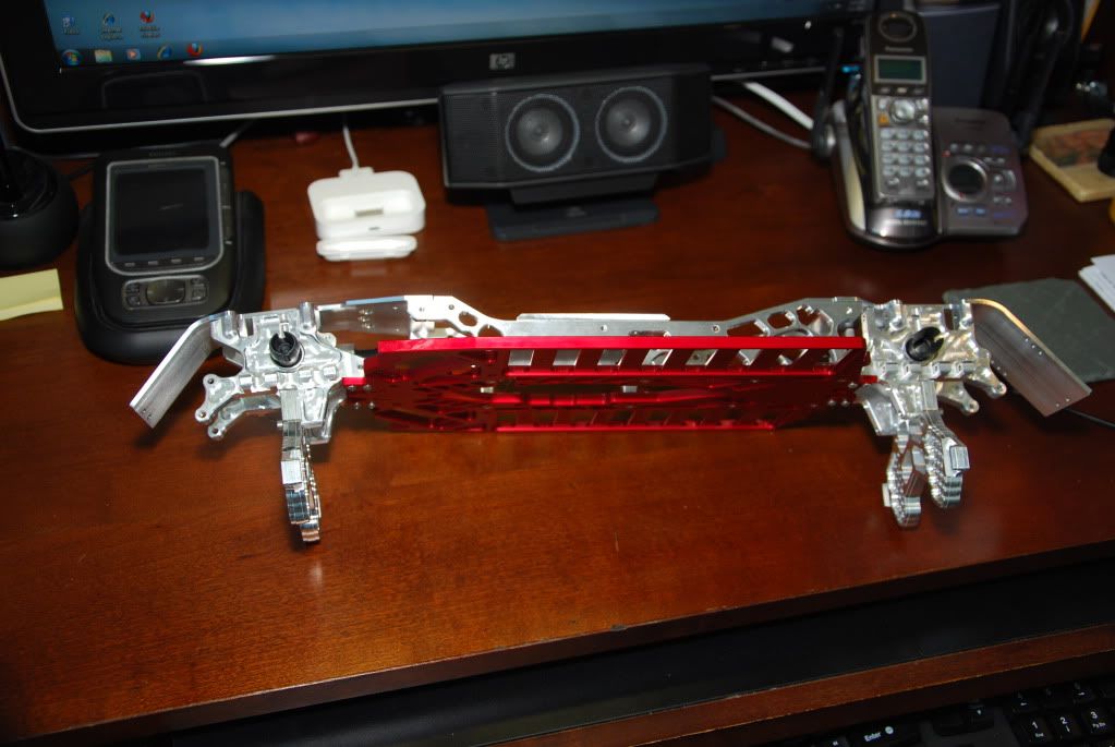

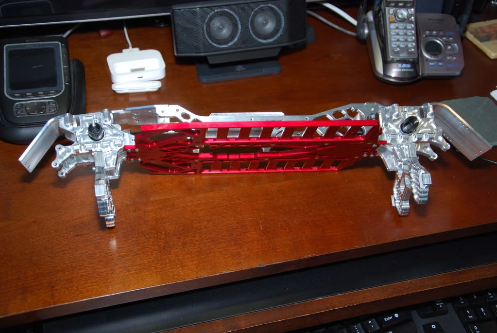

I'm not sure if there is something wrong with the new universal mount. The top plate seems to be to long, and I'm not sure if the mount was made to be used with the 65t gear. Any suggestions? You can see the gear hitting the side of the mount, and the top brace is too long.

Well, I got a response from mike. just sent him an email, and 50t gear is the largest that can fit I just put in an order for the 46t gear and a few mod .8 pinions. I will play around with the gearing to get something similar to or better than the stock gearing.
07.02.2011, 02:05 PM
It isn't too long, you need to use special inserts on either side where the bearings go in order to space out the front and rear upright parts further; the Slipperential is somewhat 'shorter' than a regular 1/8 centerdiff.
65tooth spur gear is massive though, you would normally only use such a gear on a transmission with an 18-24tooth pinion- with a CD, gears in the 40-50tooth range as what you should be using really with 9-16tooth pinions at most.
http://www.rc-monster.com/forum/show...&postcount=396
http://www.rc-monster.com/proddetail.php?prod=rcmcdmm
I suggest contacting Mike about the required custom spacers- the unit is designed to be universal but it wont necessarily be as simple as drop-in & go..
EDIT: Are you sure you need mod0.8 ( 32pitch ) pinions- the listed 46t & 50t spurs for the Slipperential are MOD1.0, so you need MOD1.0 pinions to match.

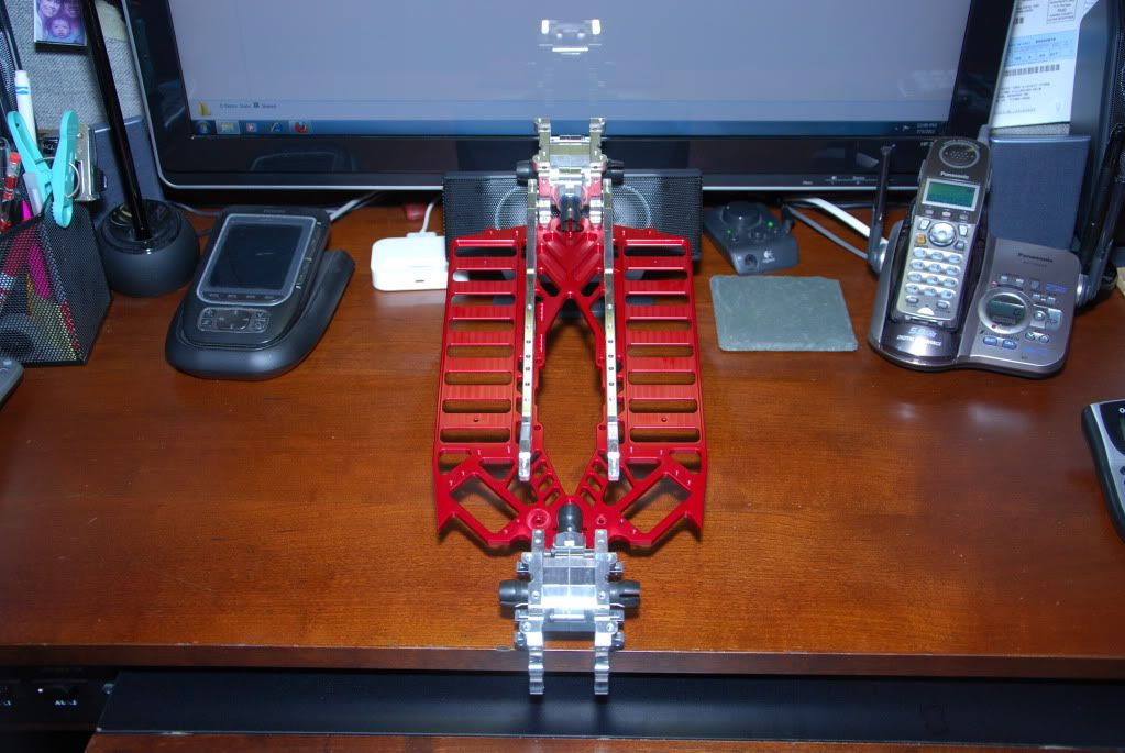

a few more pics

So i received the new upper bracket for the cd mount today. I also got the 46t spur gear. I was hopping that the smaller gear would fit between the opening on the frame. No such luck. I guess I will have to do some work with the Dremel, unless there is another way. I can't be the first to try to fit a Slipperential to the extended FLM Maxx? Are there pictures of it mounted without having to hack the frame? I don't have a problem doing it, but if I have other options I will try them first.
07.09.2011, 04:21 PM
The trouble is the new emaxx tranny is narrower than the old one, so the chassis rails are closer together as such- was never much of an issue on the older style FLM chassis for the 3906 tranny, but with the new chassis you don't have any option besides notching the chassis rails either for the spur to fit. On the upside, it should be very easy to do a neat job- just hacksaw or dremel the notches and then clean them up with a small flat or square file.
