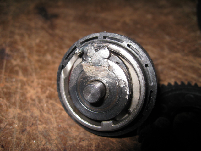

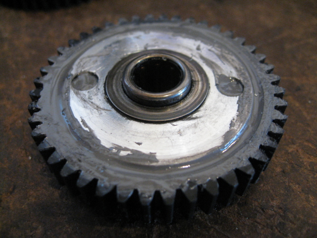

Well I haven't been posting lately, but I just broke the 44t gear in my 2 spd. tranny and thought I'd share my 2nd gear locking method. It's basically a small tack weld that i filed smooth. Not the prettiest, but works great. I snapped both of the tabs off the 44t gear and filled a new one with epoxy to stop that in the future. I also took all the teeth off the small gear if you were wondering.
