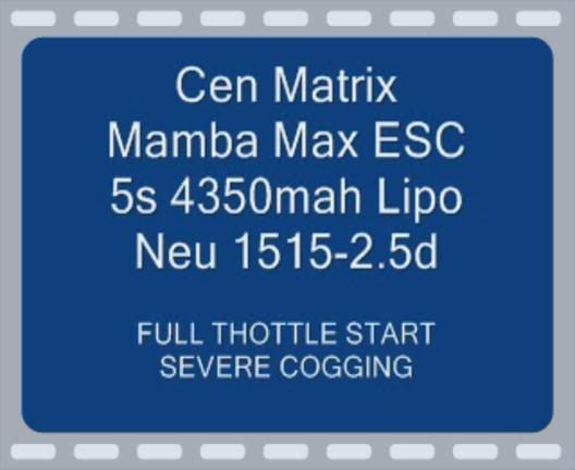

Brian,
IMO You made a wise chioce in going with the Quark rather thatn the MM with your Neu motor.
I posted this in another thread somewhere around here, but here is a vid of my test of the MM with a Neu and the MM with a Lehner. The MM ran the 2 pole Lehner bo problem. It ran the Neu, but not well IMO. In the end I actually wound up frying the MM in testing wtih the Neu motor. In its current state the MM is much less than ideal for motors with more than 2 poles. Still waitjing for an update to the MM software to help with this. I wound up replaceing the MM in that buggy with a quark and it runs the Neu motor like a dream now.

So maybe I shoudl open the 125B and install it.... than the next day Castle will release the new software update to make the MM work liek a dream with my Neu.

I was considering using a Neu with the MM controller, but now i know to get a plettenberg or use my 1950.

@jhautz: Yeah, your post (along with what I've heard/seen of GlassDoctor's setup) is one of the reasons why I didn't go with the MM/Neu combo. Even though the MM technically works with larger motors, I still feel it should be kept to lighter 1/10th scale vehicles. I was a little skeptical that the smaller 1512 series Neu would be up to the task of powering a buggy while remaining cool during the summer heat, but I think it should be fine from what I've seen here.

The Plettys are 4 pole also aren't they? Rotaryrocket has a MM and Maxximum and he says it works great.
The first time I ran my buggy with the 1512 and MM I don't recall any cogging at all. It seems that the more runs I put on it the more it started cogging. When the weather turns I will try a new MM and see what happens.
Still, I can race my car and usually not have a problem... but I do wonder every time I go from a dead stop if it will cog this time...?
