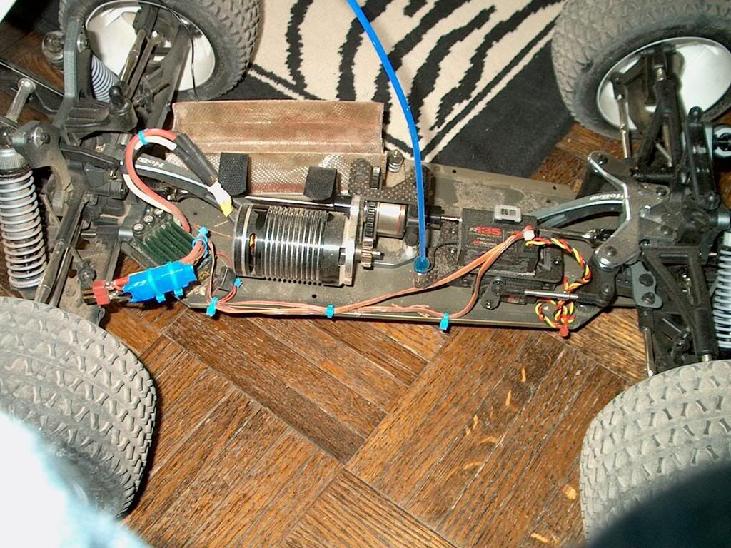

converzion is ready and drivnig several trips but the engine is a lot of heat
to BL_RVO: what temperature you?
HTML Code:
http://n4ker.rajce.idnes.cz/E-HYPER_8_ST/

Looks great niker!

Now
thats
a nice conversion...

Niker:
My temperatures are very good. About 130 on the motor, 110 on ESC with fan (newly mounted, temp before was around 140, and lipos are around 90-100. That's after a 15min run, mostly 1/2-3/4 throttle.

Are you running the 600xl or the 600l? Your motor looks much shorter than mine.

600xl

You have higher temps because the stock winds are terribly low quality in the align hybrids. Get it rewound and you'll notice a big drop in temps.
