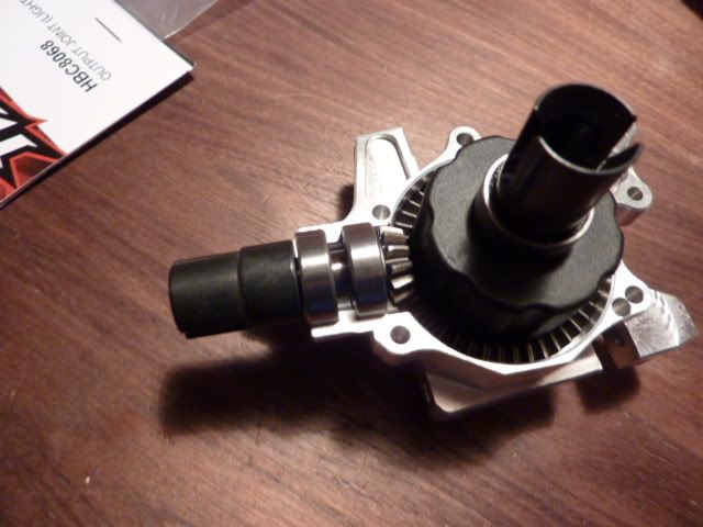

hmm is this right?
is it just the output that stop/keep the bevel gear to go in the diff?
coolhandcountry
coolhandcountry's Avatar
Posts: 6,741
Location: VA in the US
11.14.2009, 02:30 PM
I used a set of hinge pins for the top arms from a stock based ride.
The drive cup is what keeps the bevel gear from going deeper into the house.
Peace!
Country
