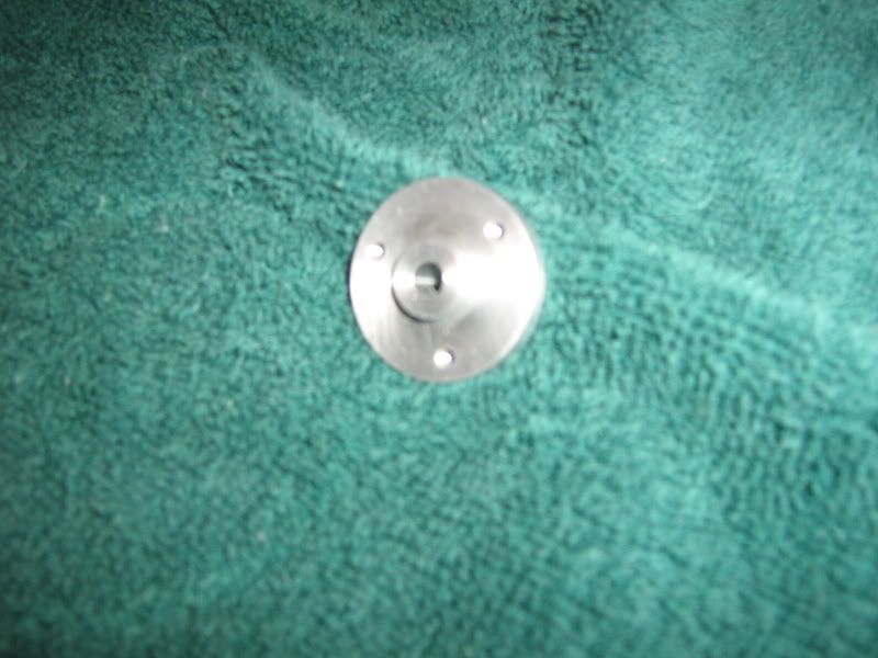

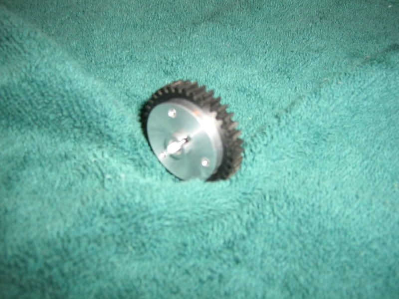

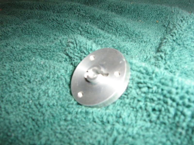

I got ahold of oomp form the traxxas forum and got the last slipper eliminator he has. I was worried for awhile there. I did put int the t-maxx disc brake and with a little work it did fit on the pad holder. I put it on and it seems to work good trying to turn it by hand its locked up.

Do a search on traxxas website it will turn up I am sure. pretty basic but I cant make it with out a good lathe with a 4 jaw chuck. actually here you go:

Heh, I spent ages searching for the slipper locker on the trx forum, never could find it- thnks for those pics. Looks very simple and straight forward, Im guessing there is a bearing in the front to keep it spinning true? Let us know how it goes when it arrives- might have to get the Candyman to make me something similar in the near future...

No bearing in the front. It just fits in place of the whole slipper assembly on the input shaft which is supported by bearings. There is a step up where the center bearing would be to center the gear on the adaptor. It does look to be a very simple straight foward design. For $17 shiped I couldn't pass it up. It would cost me 5 times that amount to make a similar item.

Ah, I gotchya now- guess the bearing only served a purpose on the original slipper in order to center the spur; the locker has that feature built-in. So simple, yet so clever

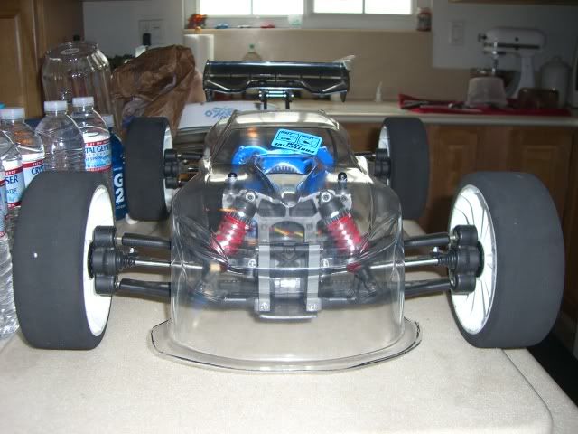

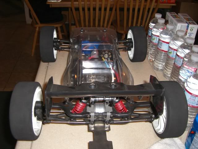

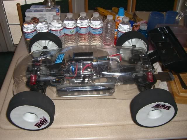

Cutting out the slipstream body out now and setting it up so I can mount it with velcro cycling my batts also. Body is turning out good, I will post pics as soon as I am done. Managed to keep more material in front creating a make shift splitter. Fifth wheel is still up in the air not sure I will have time to get it ready. I am waiting on some parts(slipper eliminator, 40 tooth gear, gyro and ofna 1/8 scale wing. I hope they come before this weekends testing. I know the days are going by fast and as long as I keep busy I should be ready. Heres some more pics:
