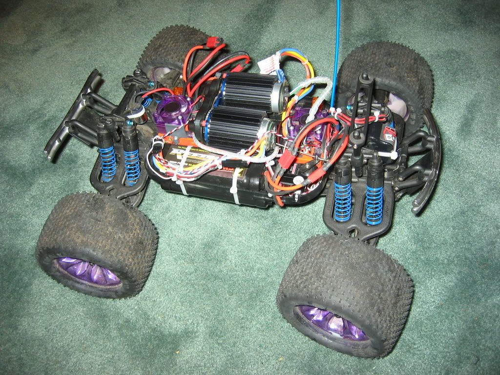

For what it's worth, I had an e-maxx with 2 hv-maxx 4400's (2 esc's). I ran 24 and 28 cells. It was pretty fun, my Neu 1515 1y on 4s is better though
Pic:
Bye
