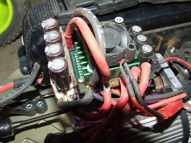

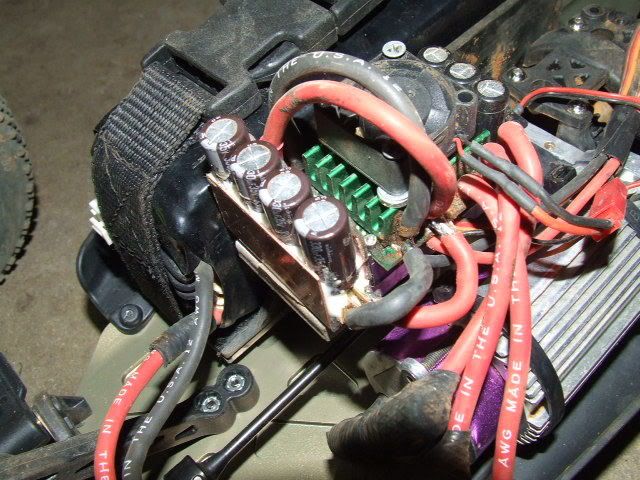

So...anyway, the caps came in today. They were waiting for me when I got home. I used some 1/8" copper round stock and put it in a vice and flattened it. I cut two strips and soldered four caps to the strips and then made a channel out of copper sheet and then embedded the cap bank in epoxy that I mixed with aluminum oxide powder. I didn't do anything fancy with the bank. I just cut away some of the insulation at the front of the power leads and soldered the cap bank in using some 12 gauge wire. Not pretty, but effective.

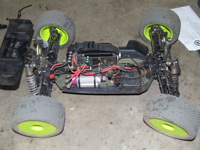

I took it out to the track to try to break it, so I ran for about 40 minutes. It was geared 11/44, which I don't think is undergeared, since I usually run 12/46 with the 8XL in a truck and 14/46 in a buggy.
After running and only giving the truck a break long enough to change battery packs, get this...motor temp 218...esc temp 110. The battery was so cool that I didn't even temp it.
I'm not willing to swear that the caps made that much of a difference, but I had some really cool running tonight. At this point, I may have to sell both the Compro and the Quark when they get back. I'm assuming that I'm going to get new units back. The Mamba Max was running way to good. When I say there was zero cogging, I mean exactly that. No cogging at all.
As far as "the more the merrier goes," it's looking like four is merry enough for the MM.
BTW, I did try the cap bank on the Quark, it didn't help. There's something really wrong with that thing.

WOW, for the nice setup with the caps AAngel!
WHOW, on the Quark trouble, that is a serious bummer! And yeah, what the BLEEP are the odds of that happening just now? I find that strange that there would be 'bad' caps, seems rare to me.
So you did notice a big difference with the MM with those 4 extra caps? Really like how you did that man. thumbs up

I've always found the Feigaos to run hot. The motor may be toast, I'll have to see. I'm going to gear it up and bit and see what happens. I just hate to gear it up because it was running perfect for the track. I may just put the 9XL in it and then gear it up.

Hmm, that looks like a nice tidy setup. Is that rust or dirt on the MM, looks like it needs a clean! Interested about the motor temp though, that does sound high- wonder what the cause is/was/could be if its mormally like that; anyone experience it when using the 8XL & MM?

suicideneil, that's dirt. We run on the stuff at our track.
