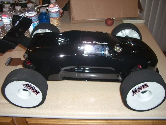

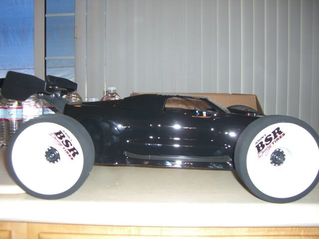

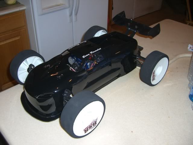

I have decided not to run the monster energy drink theme because I couldn't get permission from the company. Oh well, got some free decals coming anyway. I will use the decal kit I bought for another body I am not competing with . I painted it with my favorite color black, look so good when new. Question is should I decal it up or leave it all black? The bsr decals on the wheels and my name on the roof above the window will have to stay no matter what though. What do you guys think?. I need to finish up the front splitter. I also am thinking about getting rid of the buggy wing and make a lexan type wing with no downforce and big vertical stabilizers.

Less is more in my opinion. Unless companies are helping you out, no reason to give them free advertising (RCM excluded of course!).

BSR mounted the tires on the wheels for me but I paid for that. I paid for the whole thing no real sponsers at all except for you guys giving me some support and pats on the back. My last order with rcm I could of sworn I bought a decal sheet but didnt get it. I did get a real small one 1.5"x1.5" so I guess I use that. I will put on a small supermaxx decal also. I thought maybe put the different decals from the different product I use kinds like a contingency type deal. Maybe they will kick some free products down if break the record. IDK well see.
