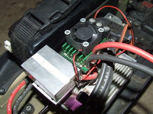

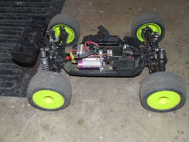

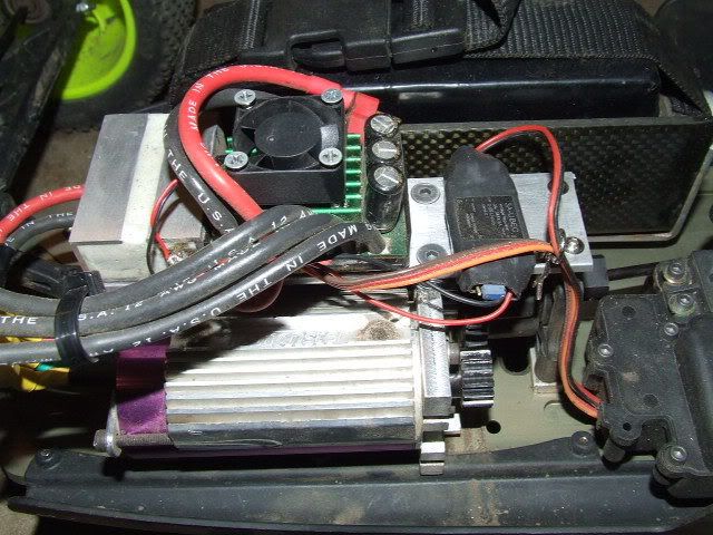

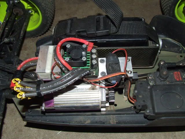

OK guys. Since the Quark had to go back to S&T, I decided to get rolling with the MM, so I cleaned everything up a bit. The 8ight is running so well, that I may just get rid of the Quark and the Compro when I get them back.
Anyway, here's the latest version of my cap bank. Again, it is a set of four caps, encased in aluminum and epoxy mixed with aluminum oxide powder.
I kept the fan on the esc for super cool running. The problem I'm having now is that I used to use the temps to adjust gearing. Now the esc runs so much cooler than the motor, I find myself overgearing and I can only tell because it starts to cog.
Right now, I'm running 14/44 gearing with a 9XL and the MM on 4S lipo. Does that gearing sound right? Do I need to go up or down on the pinion/spur?

zpb, I have it geared at 14/44 because it just starts to cog sometimes when I take off. Not bad, but just a bit. I DON'T like cogging, so I left it at 14/44. I don't know if I'm comparing apples to oranges, but I was running 14/46 in my buggy with the 8XL. I figure that if I went to the 9XL in the buggy, I'd go to 16/46. Now if you can follow my logic, I figured that I'd need to gear down a bit to compensate for the larger tires on the truck, so I'm back to 14/46 with the 9XL for being a good gearing in the truck. Since I'm running a 44T spur, I'm acutally a bit higher than I wanted. Sorry for the logic process, but I suck at math. Motor is still getting hot. About 160 after 5 minutes of "I'm trying to kill it" running.
The esc is running 120. What I know about the behavior of brushless systems, I should need to gear up a bit to run the esc harder and cool the motor off a bit, but I can't gear up any more. Or don't want to. Maybe I'll wind up keeping the Quark after all, but then I'll have to muck with the beautiful setup I have now.

I am so glad that the caps are working so well AAngel.
That's the thing now, you could gear up some, but the MM will cog like you said too high gearing.
You HAVE to tell me exactly what you did for the cap bank in alum oxide/epoxy.
I am thinking of putting two 5.5mm plugs on my custom Quark case, just so they are there for anything, like an ultra-cap bank, or whatever...

As for the plug thing, I too was thinking about that. Just makes things more versatile. The only problem is that the plugs degrade over time. I know that I change mine often on my escs and motors. I don't like the idea of having to bend them to make them tight either.
I hope that my Quark gets here in the next week, if they fix it. The way my luck has been going, they might tell me that it's not covered for whatever reason. But...if I do get it back, I think I'm going to make a bank that will fit as many caps as I can within a length equal to that of the Quark. Then I can just epoxy the Quark to the cap bank and then epoxy that to the heatsink.
The epoxy is easy. The aluminum oxide powder can be found at hobby shops catering to rock collectors. They use the stuff to tumble polish rocks (go figure). Get the finest powder that you can. It costs around $8 for a 1lb bottle. I just mix up my two part epoxy and then add the powder until the epoxy turns into a paste that looks like thermal epoxy. They you just apply it as you would the epoxy. Once the epoxy starts to heat up, it flows really well and gets into all of the nooks and crannies. I won't say that it works as well as Arctic Alumina, but it does work well. It does move heat.
gixxer, 16/46 in a buggy? Man, I started running 16/44 with the crimefighter mtrs this morning. After a HARD 5 minute run, I was reading 150 on the motor and 125 on the esc. I'm finally loading it enough to get the esc to generate a bit of heat and cooling the motor down some. What's wild is that the caps on the MM used to get hot. After a run, they were always hotter than the heatsink. Now, the caps are way cooler than the heatsink. If I get a wild hair, I might try popping the sink off of a MM and putting a better sink on it.
I do have to say that all of this leads me to some wondering. Actually, I'm starting to think that I'm full of it and all of my positive results have been figments of my imagination. I mean...if adding caps is all it takes to make things run so much better, why aren't the manufacturers doing it? I'd gladly go for an esc that runs cooler at the sacrifice of some space. Of course, I suppose I just have to keep in mind that we are running these escs out of spec; but hey, my MM got hot when I ran it in my T4 too.

You could use a larger fan instead. This one that I use is a 30mm fan. Here is a pic. It hangs over a little but It covers more area and blows more air. It is held in place with 2 screws (the zip tie is holding the ESC in place).

I don't even know where I can even get alum. oxide powder here, or for that matter a store that sells that stuff. I'll keep my eyes open.
The results you have seem real to me, if those are the temps you read... Like you said, the reason manufacturers don't use more, is space. We really just nee higher 'performace' caps, with lower ESR, and higher ripple current capability.
BTW, I though the MM had 220uF caps? I see in the pic they are three 330uF caps, that might be why the MM doesn't have as bad cap issues as the Quark.
