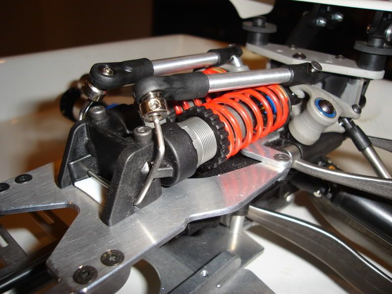

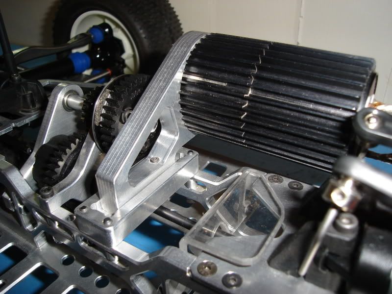

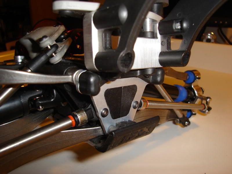

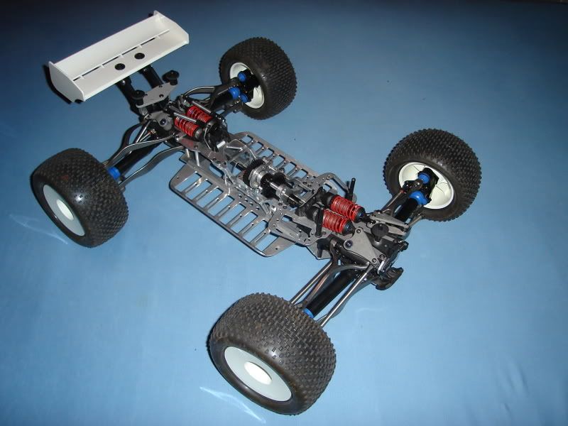

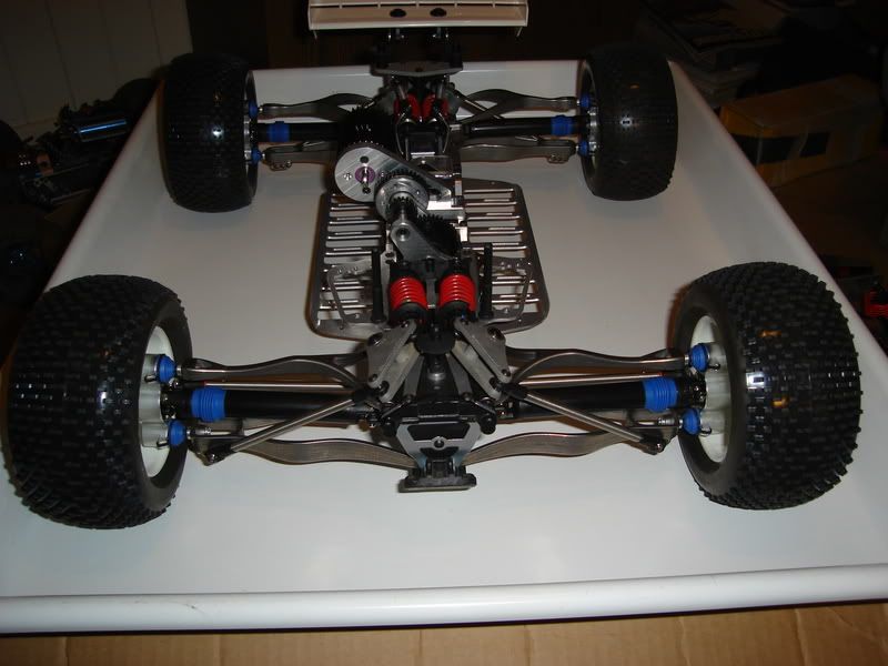

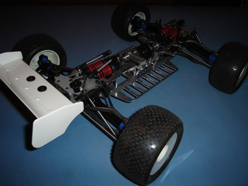

Okay, now for some pics. I made these during the last big rebuild, when most of the stuff was still new.
Please ignore things like the toe settings and the generall lack of dirt. :)
First some details:

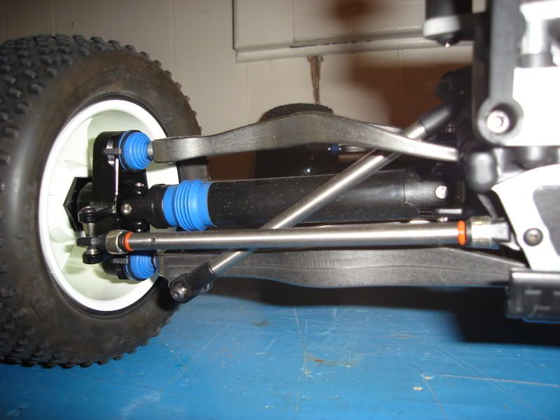

The titanium rods and turnbuckles. When I still had the RD Logics knuckles.
The new RD Racing stuff.
The rear sway bar, note the extended plates too. (I had to put some extra stand-offs under them in the meantime)

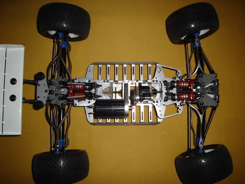

The sexy motor mount. Gear mesh is set from below, nitro-style. The whole mount can slide from side to side.

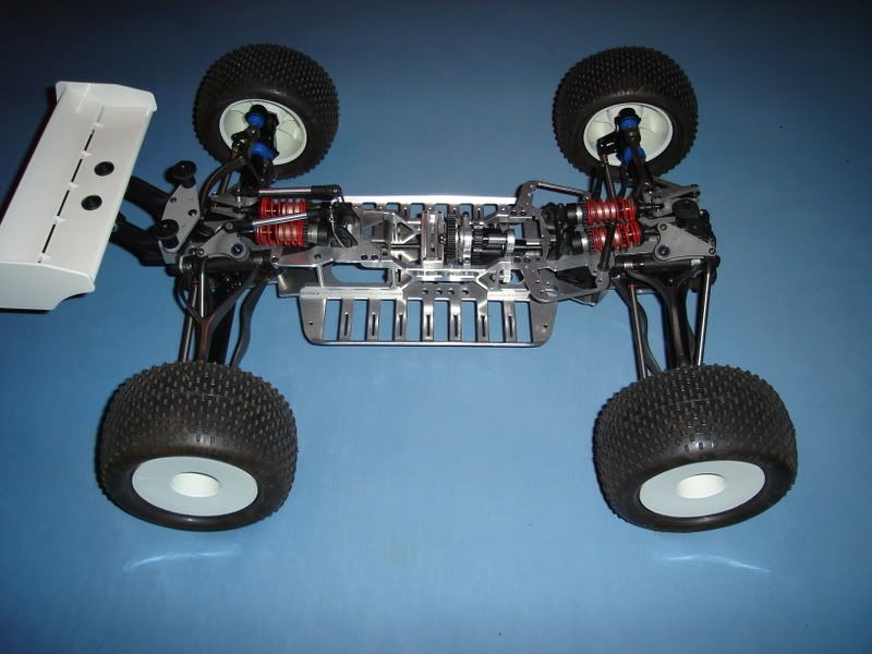

Now some complete shots!
I will try to shoot some fresh pics too. The slipperential I tested held up fine so far, the diffs too. Along the way I bent two gorilla front skid plates, they are just weak by design. One is bent slightly, the other severe. Let's hope the new ones will be better.
