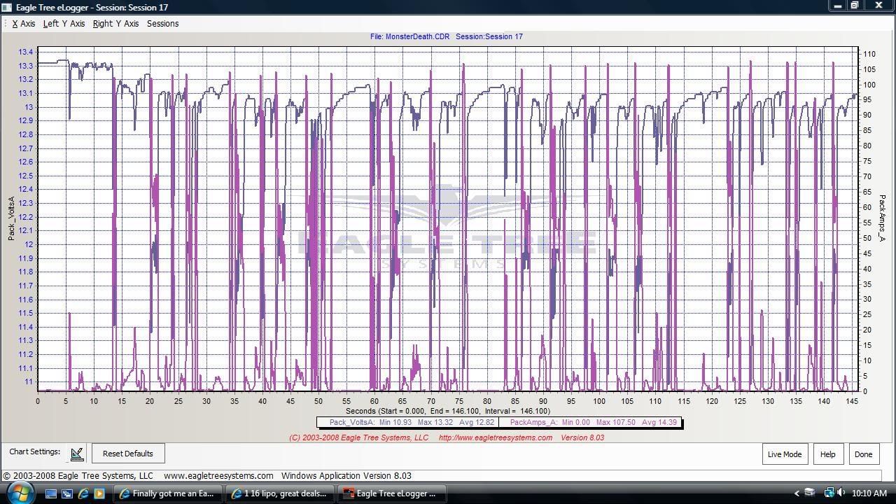

I said I would love to see some graphs on these packs. Well since I acquired a Data Logger, here it is:
This run is 4S 4500mah Turnigy Lifepo4 in an E Revo with the following setup:
HVmaxx 4400 running a sintered rotor w/5mm shaft
gearing is 14/52 using Mod 1 gears
MM Pro
It will point the nose to the air almost at will and will flip over backwards with good traction.
Still better than the A123 cells.
Looks like about 2.75 volts per cell under a 108 amp load. Check this out.

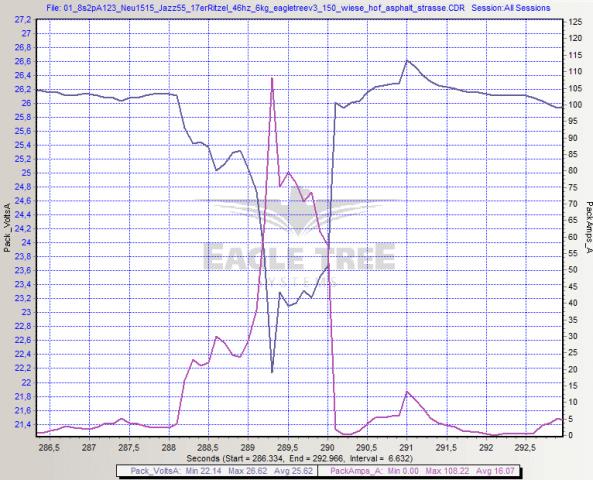

Glad to see that you are putting your datalogger to good use. I was eager to see some discharge graphs of those batteries.
I browsed through my logfiles and found a comparable one where i used 8s2p A123 cells. I zoomed into a 108A discharge peak.
. @108A voltage drops to 22.14V or 2.7675V per cell
. discharge state of my pack at this point: 1/3
There are many parameters influencing v drop: internal resistance of the battery pack of course which depends on cell temperature, cell count, solder job, discharge state and so on ...
Judging by this single discharge peak there shouldn't be that much of a performance difference between a 2p A123 setup and those turnigy packs.
You may want to browse through my eagletree file.
Maybe you could attach yours too.

Wow! Thanks for the graph. The proof is in the pudding huh?
They are pretty much the same. My graph was fully charged but on a cold day. 35 degrees or so outside.
Yes, there are many variables that alter a packs performance. That's for sure.
