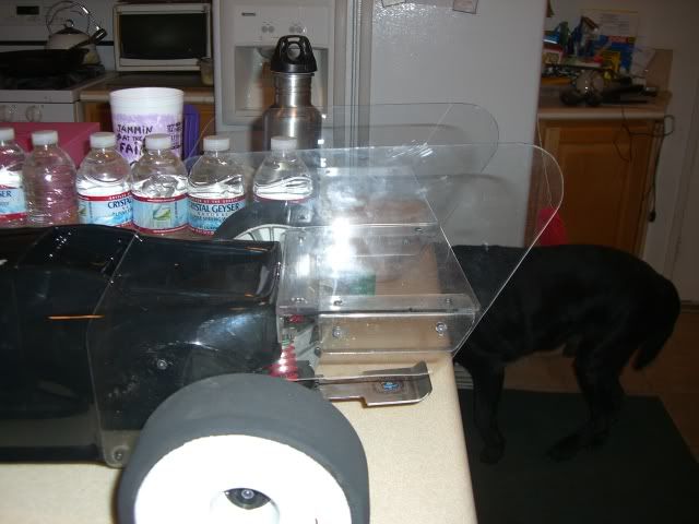

I built a new wing out of lexan with huge verticle stabilizers. Because the 1/8 scale buggy wing has too much down force. See pic. Since I didnt have time to test it I would have to test it at the ISC event. First pass: I managed 70 mph with no back up speed so its still was unofficial It had Lost of tire spin when I got on it and it was hard to control. Second pass: I lost control some how and drove on the opposite side of the timing lights and crashed so no speed. Found out that my cheap little gyro had failed and I had no steering at all. No Wonder!! Third pass I managed a 79 mph pass officially bacck up with 78. Forth pass I managed a 81 mph officially and everybody was tripping. I gave a little show and poped a wheely with some ti sparks also they all loved that. I think I am getting better at driving it. Let see if I cant get it too 100mph tomorrow. Better driving and 2 more higher gears might be the ticket.

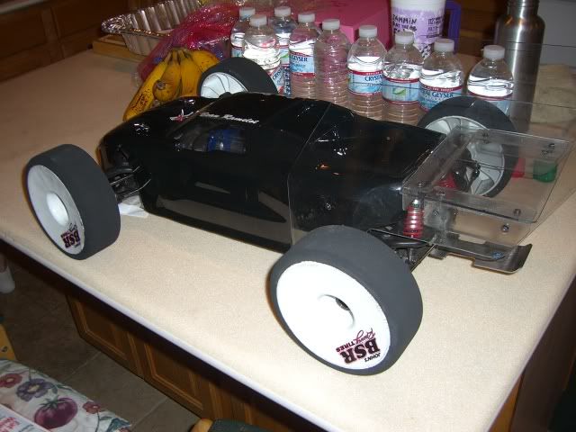

I won the open wheel class and also hold the current ISC world record. Not to mention probably the fastest e-maxx based truck ever! I am sure the truck could of gone faster but equipment failure because of extreme gearing. Traction issues when I rolled into the throttle the tires broke loose and the truck pulled hard to the right side causing me to correct all the way down the track were my limiting factors. I actually needed more test time to get it dialed in and I am sure I would of broke a 100mph. Overall I did win and I am very happy about that. I want to thank all of you that supported me in this venture :cheers: . Heres some pics.
