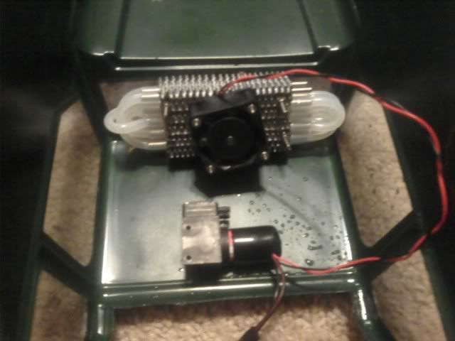

no, he builds pumps with no moving parts. but he had a small 5 volt pump on his emaxx one time but i think it was from work though, so its not available to the public.
but that pump should work.
he also made his own radiator out of aluminum.
shoot i will just through in some pics
sorry guys no hands.... lol

I use the watercooling setup with my Hydra 240 and Neu 1527 1D and without the working water pump and a home made radiator similar to the picture up top it made my temps to drop from 170 degrees to 98 degrees on a summer day in IL. It works on cooling but not on ESC I beleive due to a rapid rise in heat when the ESC maxes out. It will cool down better than a fan but won't save the setup when the ESC goes up in flames. I was also using a 5volt diaphragm pump. The TCS pumps is a gravity feed and when your trucks rollover it needs to be primed in order for it to work. They are a piece of crap and not worth getting for 70.00. It does work just too much lines and a little weight.

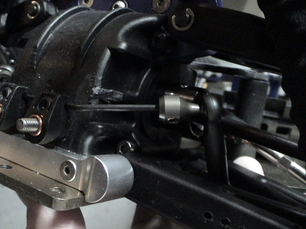

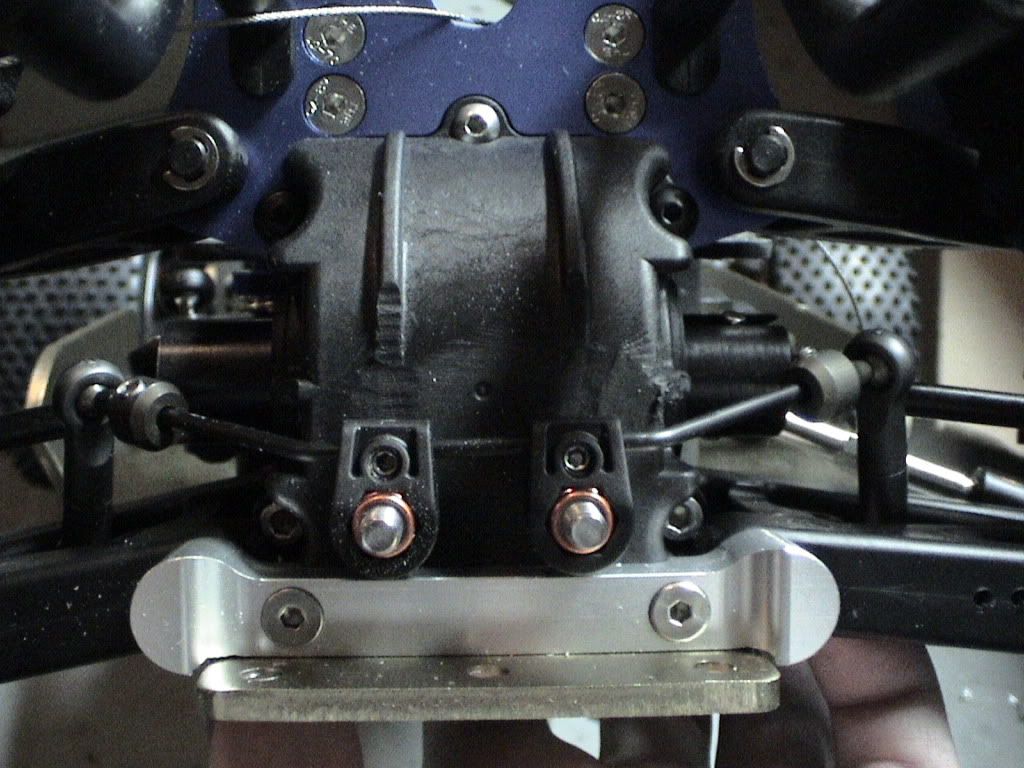

anyway, here are some recent pics. here is my front swaybar installed. now the rear is next.
Photobucket
Photobucket

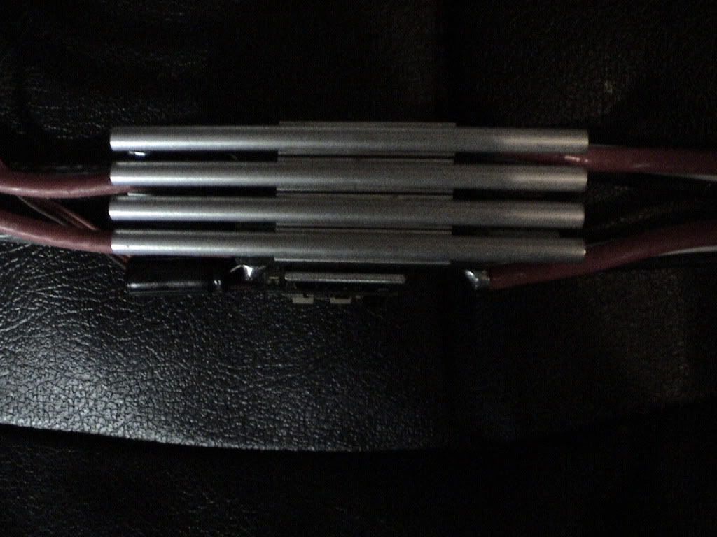

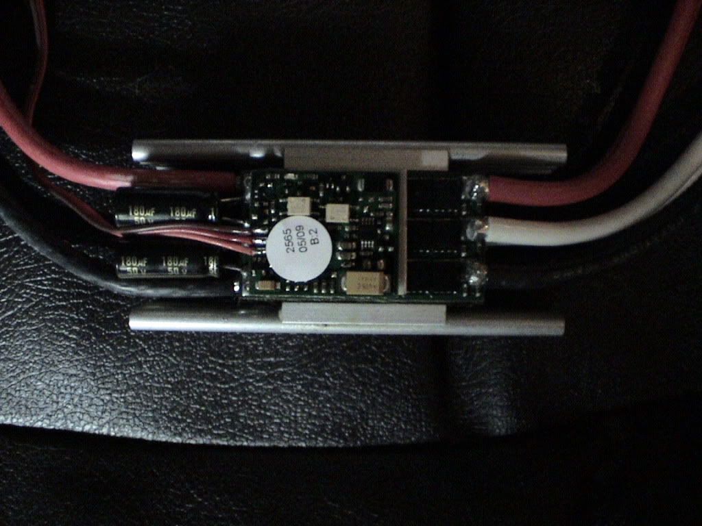

here are some pics of the esc without the shrinkwrap. a fan would cool it decent i think on that large top alum. plate but the water cooling would just be soo cool. i will have to see what i can do. also, here is the rx/esc box i am planning on using. it fits everything perfect. i cut holes on each end for the wires to come out and then i am gonna use an outerwears material to cover the holes to keep the inside of the box semi-sealed off and safe from elements. (even include some hand porn.)
Photobucket
Photobucket
Photobucket
Photobucket
Photobucket

The links for the water reservoir looks tricked out. I think this is all you need and the pump that they are selling. The TCS pump is small and looks real good. But it works good as long as you don't roll over as it needs gravity to feed the pump. Also you need a high volume tank for it to work as the more water it has the more pressure gets deliver to the pump. I tried it but it's very unpredictable on pumping water. You'll just find out it's not working when you check the temps on the water. When it works the temps is about the ambient temp of the outside but when not it gets pretty hot. Watercooling really works on cooling the motor, it's pretty amazing to see that my motor went from 170 degrees to 98 degrees on a 90 degree weather.
