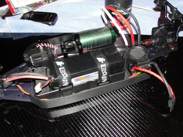

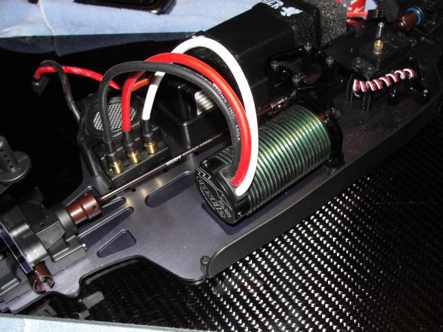

Had some time to tinker with my XT8E.The RCM kit fits the Xray kit perfectly plus the Xray parts quality is exceptional.Very easy build so far.The RCM even has mounting holes for the MMM ESC.Now what motor?
