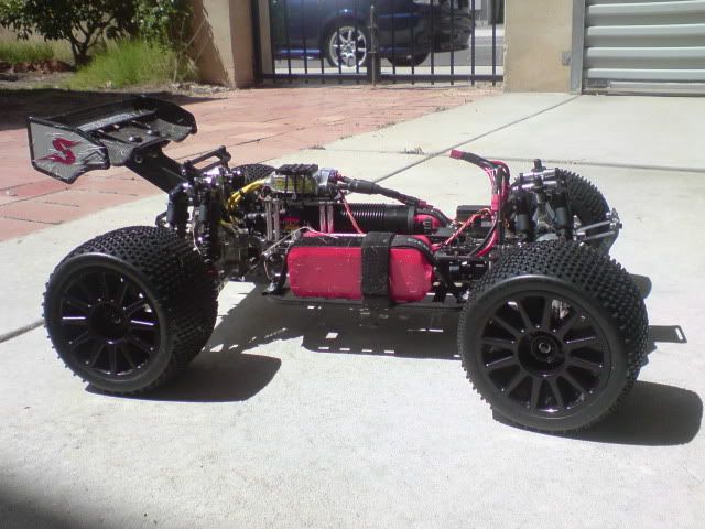

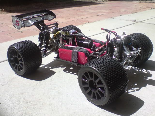

Ask and you shall recieve!!! I took these pics when i just got back from the run. Also, im thinking about asking Mike to CNC me CF or Alu motor mount so i can change between pinions easier.
Thanks for the comments as well Jerry, it was good to finally see it running and not break anything!!
P.S you can see i heatshrinked the piggybacks as well in case one of them decided to blow out, i wouldn't lose the cap, just some extra insurance

It looks like a nice clean setup Jordan. How much does that thing weigh with everything onboard? Those batts must be pretty heavy considering the size of them? What are those 8000 mah's? And what voltage are you pushing through your ESC? So how do you like running the center diff as apposed to using a tranny? I will probably setup my SuperMaxx with a center diff once I get a big motor for it. I have a couple Torsend diffs and I was thinking about trying one of them as a center diff to see how it works in that position.

Roughly 14lbs all up. The batts are 5000mah a piece, running in parallel. So pretty much have a 5s 10,000mah pack in there. To be honest i have never run a brushless truck until today, so comparing to the old e-maxx tranny with the titans, i like it. When you take faster corners and the inside wheel starts to lift it seems to settle it down a bit more.
