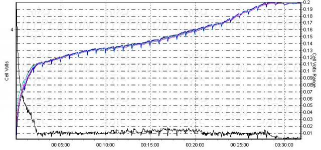

a zoom in look
For a comparasion, here are the curves from one of my other packs
all curves are close each other and have unique shape,
I am completely puzzled, what has made this difference? if long storage time harmed the pack, why only half number (3/6) gone bad while the other harf stays healthy? Any appreciatable suggestions to help me save my investment ?
Thanks guys.

Took a quick look at your lipos just now Hardstyle.
Seems like one of the robbe lipos is a bit out of balance. The other seems ok. Did you fully charge.balance them before you sent them to me?
One of the maxamps lipos has a small amount of damage to it on the end. Otherwise they seem to be hold voltage reasonably well. What did you sue them in? Did they puff on you a bit under load?
