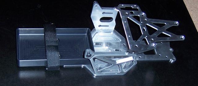

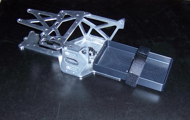

naked kit pictures - 06.09.2010, 11:36 PM
here are a few pictures of the assembled kit without the Baja attached. :)
ID:	9001   Click image for larger version
Name:	ebajakitassm bottom.jpg
ID:	9002   Click image for larger version

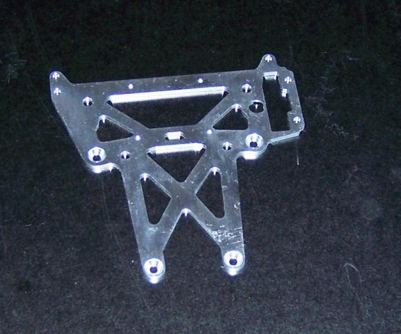

more pictures - 06.10.2010, 12:19 AM
A few more pictures
Name:	ebaja lower plate top.jpg
ID:	9004   Click image for larger version
Name:	ebaja top plate.jpg
