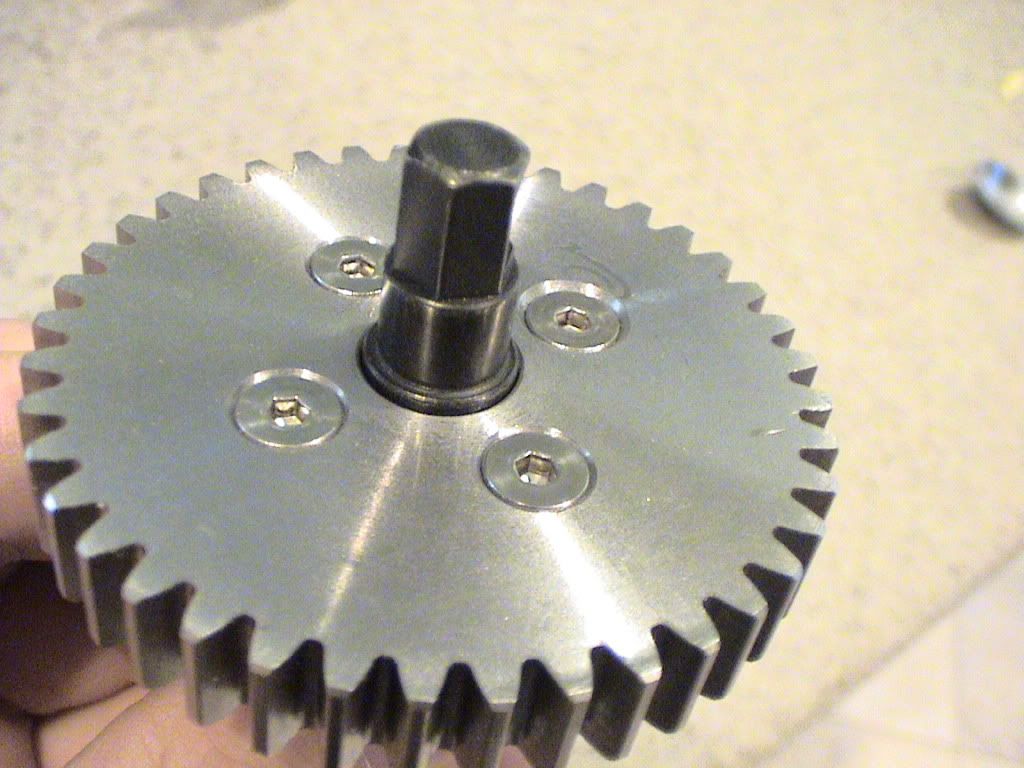

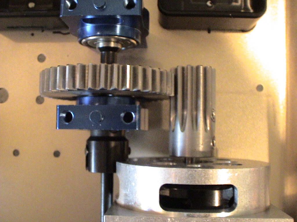

Pinion: https://sdp-si.com/eStore/PartDetail...upID=591&Qty=1
Look here for the spur: http://www.qtcgears.com/RFQ/default....rs/KHK064.html
Part number SSA1-60. The bore is 10mm but the tech lady said there was enough material there to drill the bore out to 12mm.
QTC doesn't have anything with a hub & set screw

I think Mod 1 gears is the way to go...there are a lot more gearing options.
The bore on the 60T mod 1 spur is 10mm though...shouldn't be that hard to drill it out to 12mm.
Mod 1 60/15 brings the speed down to 48.33 mph.
qtcgears.com also has some good choices.

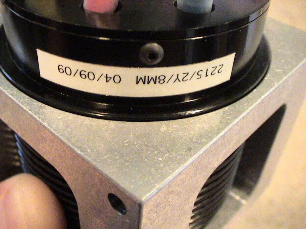

if youre gonna go with mod1 gears you will want to get a 5mm shaft 2215. there was 2 of them on ebay recently that didnt sell. they were brand new and were up for like $350 if i recall. the seller was jvmaxx. i have bought several motors from him and he is a great seller. anyway, i want to stick with mod1.5 and 8mm shaft myself. if all else fails i will switch to mod1 as a last resort but i think the mod1.5 setup is gonna work just fine. i think a 40t/15t setup is gonna work. i could be wrong but i will know soon. also, Mike initially said that he was gonna have mod1.5 pinions from 11t - 22t. i imagine he just got in the most popular sizes initially since everyone was hounding him about getting these mod1.5 pinions. perhaps he will have the less common sizes like 11t - 14t shortly. a 40t/11t mod1.5 setup would put the speed at 51mph which i think would be reasonable. or there may be a way to get a 42t spur somewhere. i think a 42t spur would fit in the ramp. you could even go with one of those 48t spurs if you wanted to build some shims for the center diff mounts and mount your motor a little higher off the chassis maybe. the center driveline would be angled a bit but it could work. idk, basically there are a lot of options to make the mod1.5 work. same for mod1 also. i had considered going with mod1 myself but i figured they must use mod1.5 on 1/5 scales for a reason and was worried that the mod1 gears wouldnt be strong enough to handle the torque.

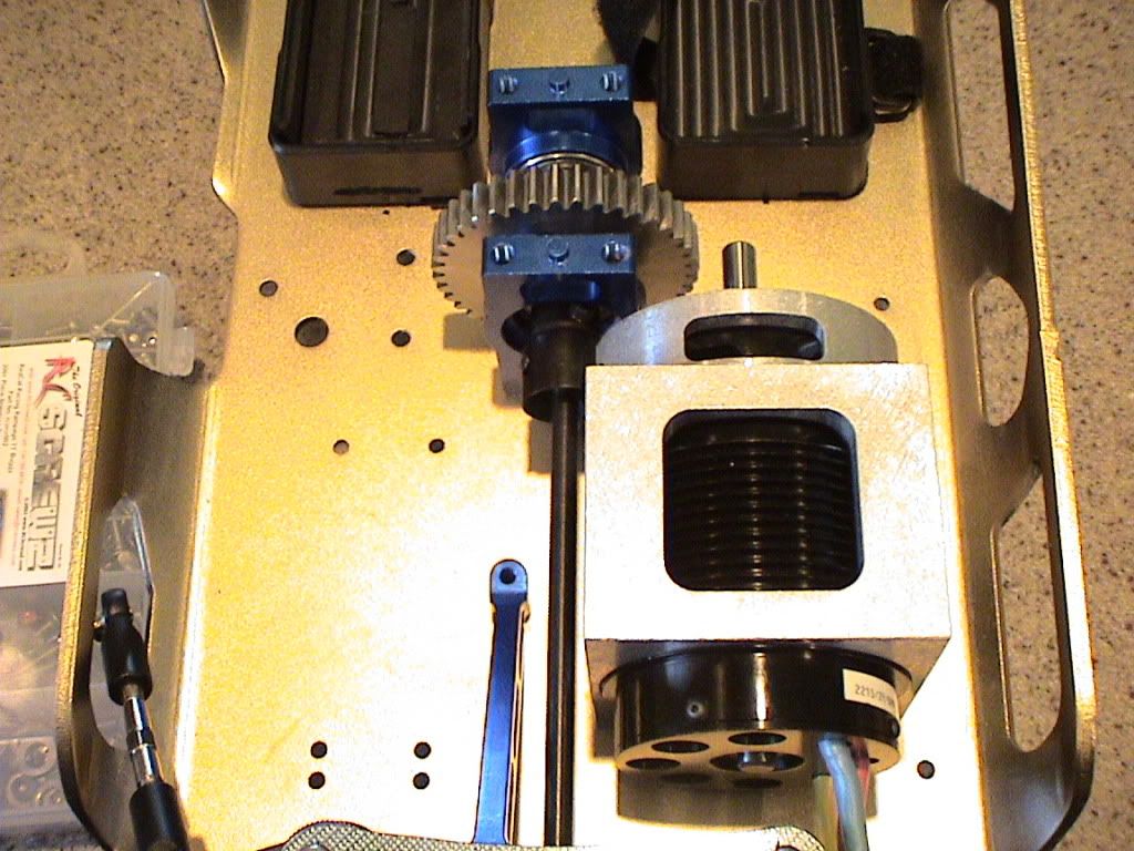

oh btw Kaz and others,

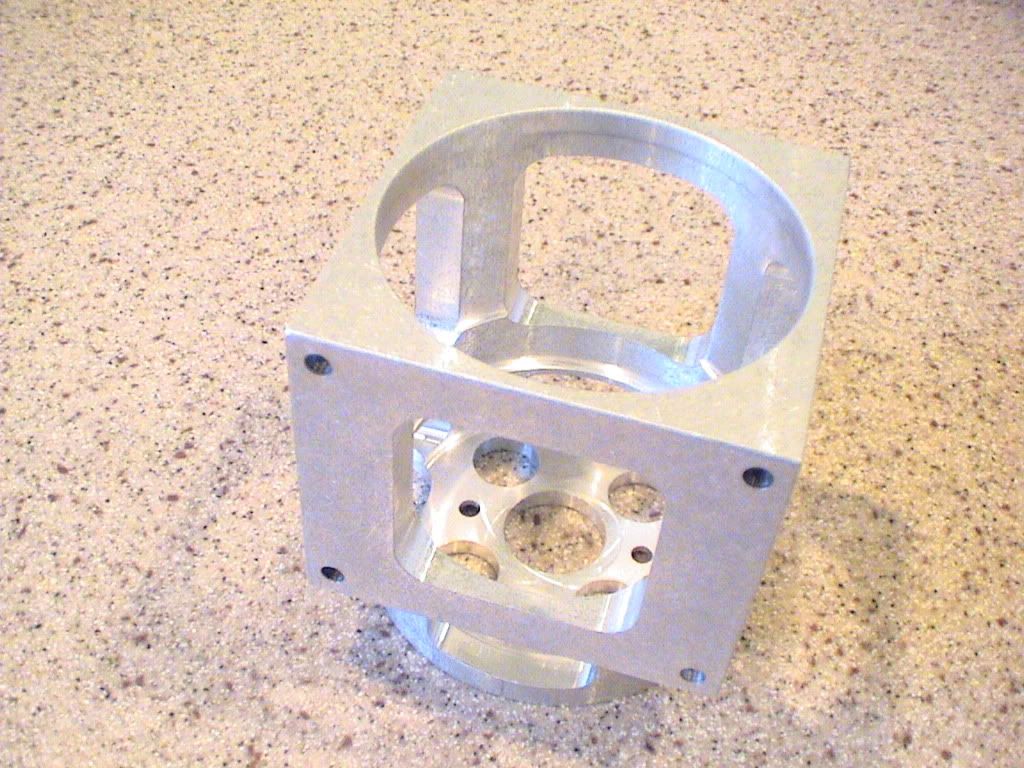

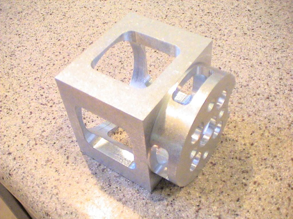

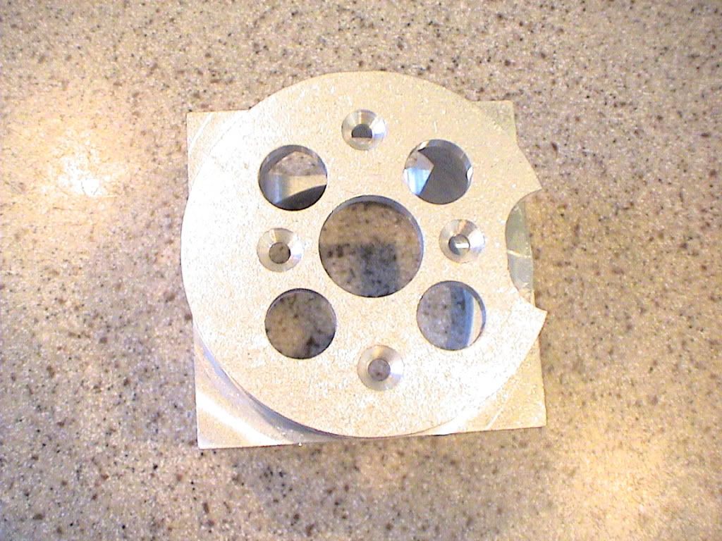

i talked to OSE and they said they would have these mounts in stock for the 2215 in about 2 weeks. you might want to email them in a couple of weeks if you havent already found a mount. http://www.offshoreelectrics.com/pro...jwr-mount-flat
also, i am having 3 made of my own, so i will have 2 extra. we worked on CAD designs on tuesday and already have the 3x3 alum block. the shop is supposed to have them done this week. they are gonna be awesome. CNC'd from solid billet 6065 t6. they will have all the holes needed for great airflow. i cant wait to get them back. i still have no idea how much they are gonna cost me but i am hoping not very much.

I think if we could get down to a 10T Mod 1.5 pinion that would be ideal sdp-si.com has a 12T
qtcgears.com has a 42T spur but it has a hub so you would have to grind it off or something.
You might be able to shim the locker mounts and top plate up to get the 42T spur to fit but then you migh run into binding on the dog bones. sdp-si.com does sell u-joints...

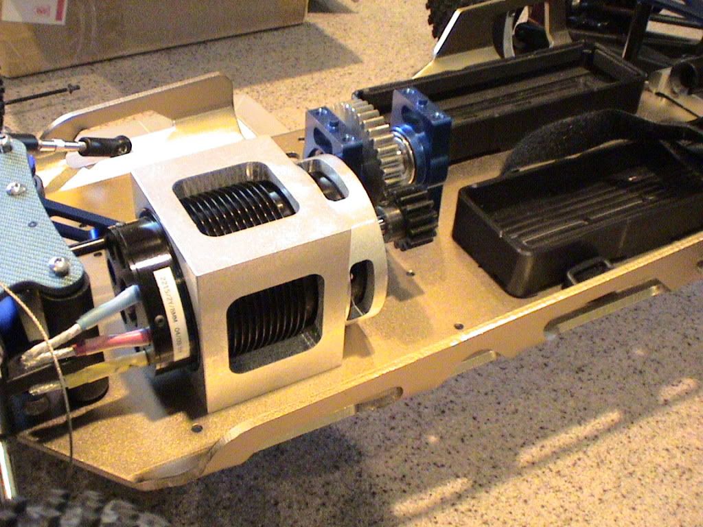

i just ordered a couple 40t spur gears and i found a 12t pinion gear that will work. its kind of thick but that will give me more room to set mesh and where i mount my motor.
https://sdp-si.com/eStore/PartDetail...87&GroupID=591
https://sdp-si.com/eStore/PartDetail...74&GroupID=591

i just punched in the figures on the rc-calc and the 40t/12t gearing i think will work sweet. that gives a theoretical speed of 57mph which is the same as all my 1/8s. in reality it will probably do around 50mph which is what i am after. now i just have to hope that this gearing will work and provide cool temps.
