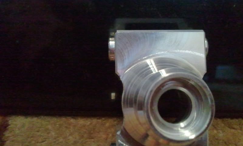

In order to get these to fit with my savage lower arms, i will need to grind down these protruding alloys nubs. Nothing a bench grinder cant fix

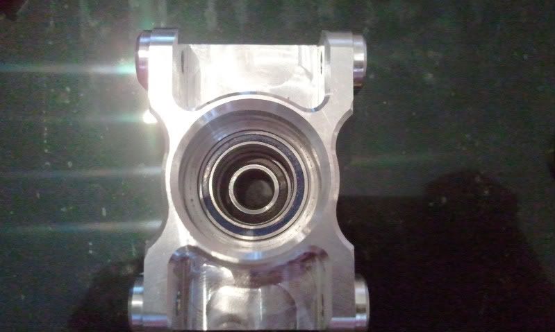

Thanks to brian on here, another reason i upgraded to LST Hubs was because i can utilise 3 wheel bearings which will help the hubs cope with the heavy Baja Wheels.
This is how they would sit inside the hub

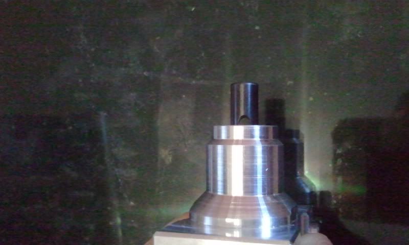

In order to get the 3rd bearing (centre bearing) to sit snug inside the hub as it wasnt originally deisnged for a 3rd bearing, i will need to wrap the outside of the bearing in a single layer of cello-tape. This is enough to get it to fit snug. Anything thicker wouldnt allow the bearing to sit.

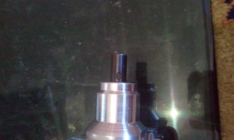

I even tried to see if i could use 4 wheel bearings, but due to the axle increasing in diameter toward the shaft end, the axle cant sit deep enough. So close, but no cigar...
comparison of how where the axle pin sits with 3 and 4 bearings
3 Bearings
4 Bearings

Hope it does what you want but I'm not sure it will help; the forces should be on the outer and inner bearings because that is where the flex points on the axles will be I would imagine.

The way these fail is that the force on the tire/wheel pivots the axle on the outer bearing and the skinny 22mm inner bearing fails. Anything that can help support the axle on the inner side of the outer bearing should help these sustain that force.
Josh - I agree that having the third bearing closer to the inner bearing is best.

Considering what you have said, i took a close look at the hubs and bearings...
There is around 4mm of play for the 3rd centre bearing.
I will make a 12x16x4mm spacer made up which will push the 3rd bearing towards the shaft supporting the load on the larger,weaker 22mm bearing.
Hopefully this should help take a little stress from the heavy baja wheels... If it works, then awesome, if it doesnt, then its all good anyway...

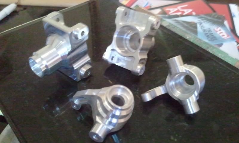

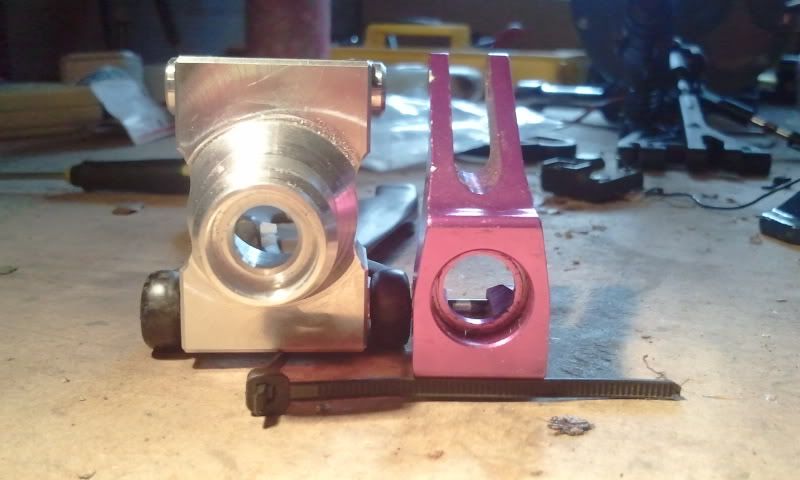

I also took some comparison shots of the LST 2 Alloy hubs and the Suspension conversion kit hubs...
This looks like they will add some weight, but should add stability to this brutal build and should deal with any 60mph cart wheels hopefully *:twisted:

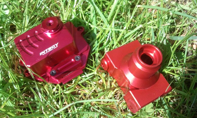

Look what arrived today
Not exactly the red i was hoping for, but i am still happy with it...
I was hoping for this finish on the integy RX box
Some of my alloy mounts look a little dull, but i guess that is because i didnt prepare the surface and polish them before the anodising...

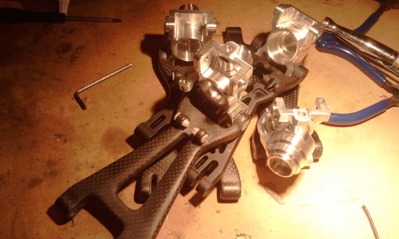

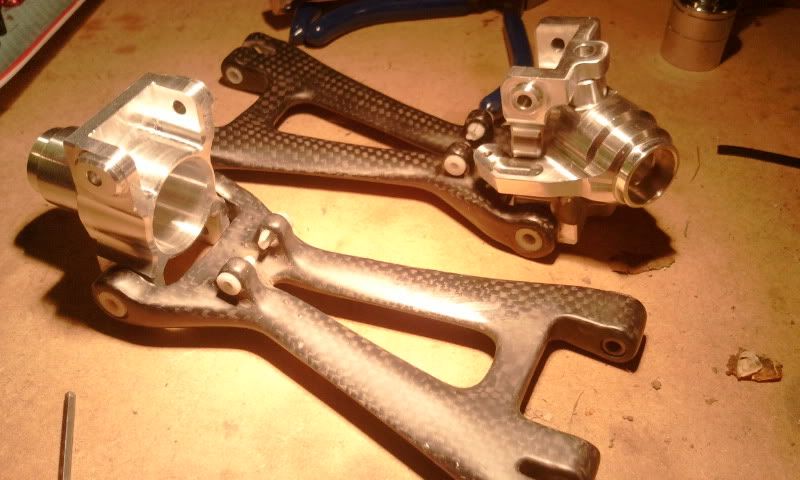

Small Review on Carbon Arms
Finding a method to mount my sway bar with the Carbon arms, is proving difficult. There is no original mounting hole...
Mounting the bottom shocks to the arm is also difficult. Plus, i feel there is also a lot of binding. Yes they look really good, and i believe they will perform well offering great rigidity, but i may sacrifice all that and put the stock arms back on...
This will not be a build i can put together so quickly.
I am waiting on little things like shock bolts, and having to customise this and that to make things fit and work...
