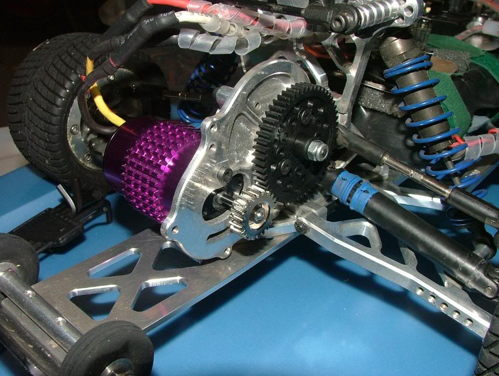

I prefer the newera skidplates and wheeliebars. They are a bit longer.

lutach
lutach's Avatar
Posts: 5,139
03.04.2008, 11:43 PM
I'm going to take a picture of my skid plate tomorrow. It's not fancy.
