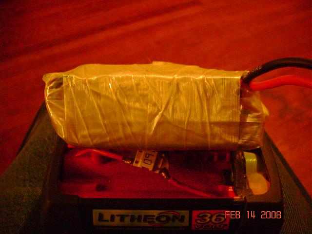

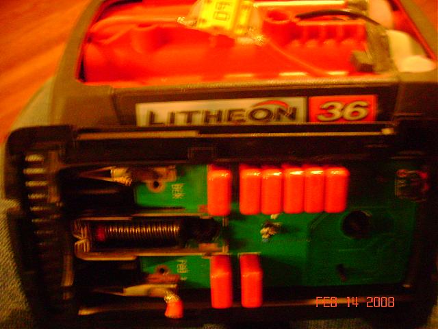

I have bought a few Bosch packs and I was wondering why did they add a 60A fuse. Now I see why. I have used my packs and they are really powerful for their size. I will use them more often.

Here are a few pictures of the smaller 36V pack as well as the bigger one and the PCB that hooks up to the charger. I left the 60A fuse when I wraped the smaller pack.
