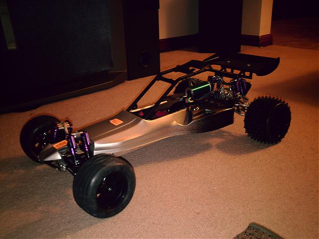

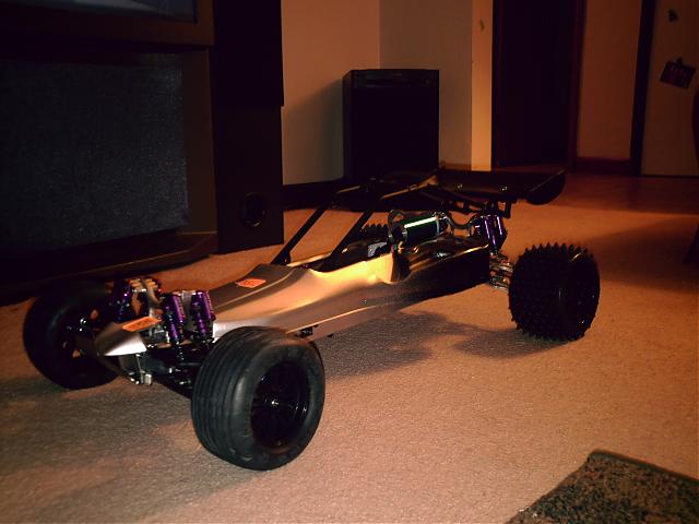

I have made some progress. I got the cage and steering servo mounted. I am happy with how the cage turned out. I can take it off my simply removing four retaining clips. I am waiting on a pinion from Mike and body mounts. I also need to order a roof plate for the cage and thats about it.
I was surprised when I weighed it and as it sits it weighed 12lbs 9.09ozs! Thats much lighter than I thought it would be. When I'm done it should be at or just over 13lbs.
@othello: I have seen your videos before and they are impressive. This thing is going to haul with a 9xl on 6s2p, but I want to run a HV setup like yours. There are to many reasons not to go HV IMO.(besides relatively high price of esc). I plan on buying a jazz and running 10-12s with my mega 22/45/2
Over all I am very happy with it so far, we'll see how it runs.

That is fantastic. I want one. Get a picture of it beside a real 5B. Will be interesting to see how it compares to the 5B speed wise with it's current power setup.
Revracer
Revracer's Avatar
Posts: 323
02.26.2008, 09:45 PM
man thats amazing. what wheels/tires are those?
lydiasdad
Posts: 174
Join Date: Oct 2005
Location: Illinois
02.26.2008, 09:55 PM
I actually planed on getting a side by side pic when I'm done. I don't think I'll have any problems hanging with the actual baja's.
The rear tires are 40 series mulchers and the front are IMEX rib dawgs.
