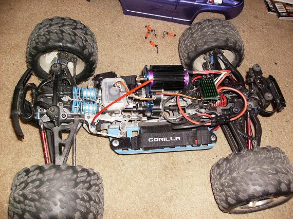

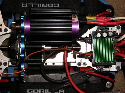

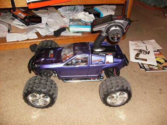

YEE HAw!!! LOL I finally got it going again! MM/8xl on 12 cells for the moment. Waiting for the CC BEC and 19t pinion from RCM to come then it will be 4s lipo!!! right now it's only running about 20MPH and the steering is really sluggish(mostly due to crappy servo). Hopefully with the BEC set at 6V it will help the servo until I can get something better. The one in it now is only like 40 oz/in torque that came in the truck. I'm really leaning toward 2 traxxas waterproof servos when I get some more money, at least it's moving for now though. Here's some pics, any feedback about any of it is appreciated, setup, wiring layout, whatever you see that could be better please let me know!

The only thing I would suggest is to forget about the traxxas waterproof servos, and pickup something with metal gears and around 200oz/in of torque. Other than that it looks fine. Will you be getting a motor clamp to stop the endbell from popping off?...

Didn't know that would be a problem, so thanks for enlightening me! I'll place an order for one in about a week. Wanna get it fully running on 4s and see what else I need, possibly different pinion or something, wanna order it all at once. Thanks again Neil
