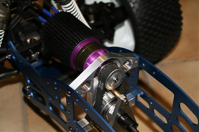

A guy from germany has done a belt driven nemesis, it was pretty cool. Cant find the pictures anymore. But heres the video http://www.myvideo.de/watch/940850

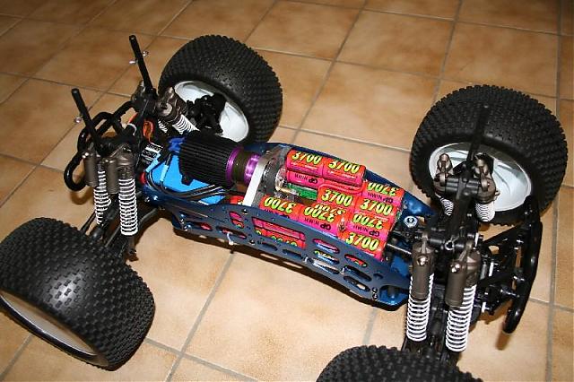

The pics of his built are gone. But this is what he wrote about his truck.
Motor: lehner 2230/16 with a Reisenauer Gear reduction 6:1
Controller: Schulze 40/160
Batts: 24 x GP 3700 Nimhs
Geared for 34 mph. 24 minutes driving per charge. very low temps of every component.
He made a custom mount for it to be belt driven. That's all i remember.
But i guess a belt would't hold up the power aqwut is lookin for.
I hope he doesn't get angry at me .

Seems as if your hard disk is well organized when it comes to rc. Those were exactly the pics i was looking for.
I liked the way he set everything up and I was going to make something similar with the belt drive system.

Wow that belt drive setup looks factory! Now the only issues is he needs to go lipo.
03.16.2008, 08:00 PM
Yeah, I think he built that truck before lipo was invented/mainstream & easilt available.
Seems like it would work in a Savage too, or any TVP type truck (I need to buy another TXT-1, oh how I miss the old girl....).

If i remember it correctly he comes from hi speed boating (Saw events) and at this time Nimhs were prefered for hi Amp draws (lipos weren't allowed i think). Wheight isn't always a bad thing especially when it comes to handling on a rough surface.

yeah, that GST build was nice.. I saved the pictures too.... I like the belt system, I thought of doing the same thing, but I'd have to use double kevlar belts..

Hey Aqwut, why not go with the dual 1527's and a dual-belt system? If I refer to the gear on the center differential or whatever it drives as the spur gear, and the gear on the motor shaft as the pinion gear, then why not have a very similar layout, except with places to mount two motors, instead of one, like the E-maxx motorplate, and have one "pinion" be farther out than the other by mounting the second motor farther forward by the width of one belt to avoid the belts hitting. Then have dual "spurs" (one right in front of the other,) hook up some belts, and you're ready to go. I hope this will give you an idea or two.
