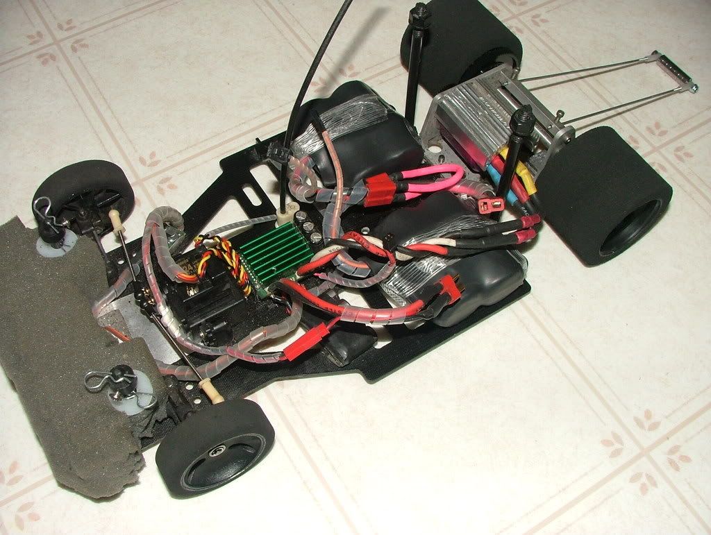

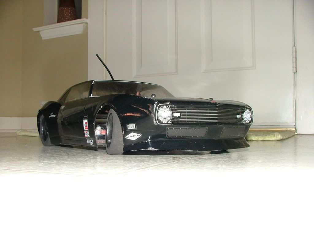

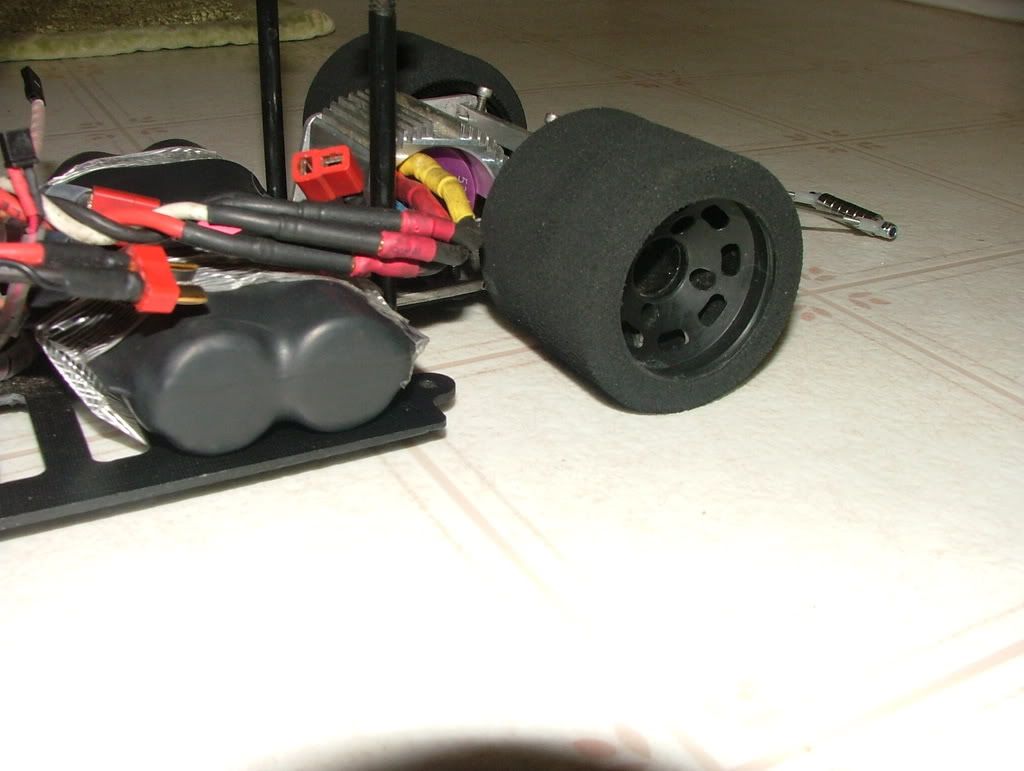

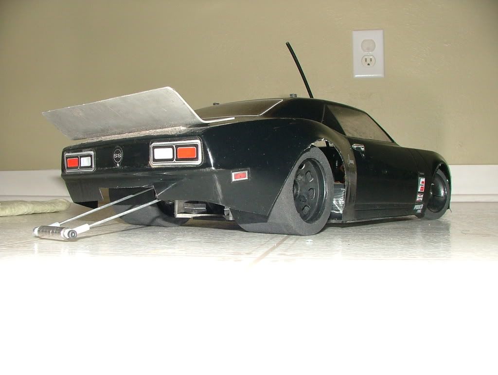

I went back to 48P gearing, and will run 4S. Refoamed and trued the TM nitro wheels. Gonna need all the traction I can get. Wheeliebar should work better now, with all the ballbearings as wheels and enough flex to keep the rear tires planted at launch. Motor choice is a Lehner Basic 5300. Previous motor was a 9T hacker C40.
Should be a fun car throughout the year.
