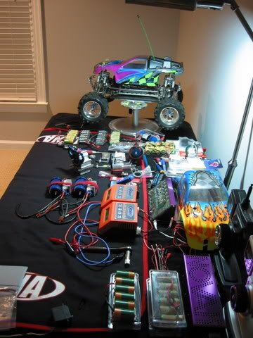

Ya its gonna be a powerhouse! You got a bulletproof tranny, diffs and how are you going to get the two systems to run insync with each other?

both esc's are hooked to channel 1 of the novak RX with a y-splitter...i got the cable from ICARE when i purchased the electronics!

That doesnt guarentee that both motors will spin at the same rpms though.

Wait... Channel 1? Channel 2 is typically for throttle with pistol grip TXs.

The motors will be spinning at the same rpm since they're on the same spur gear.
If your using 12 cells on each esc now, I'd use 2 4s packs of the same age and specs. If you use 1 4s pack on each side you won't be able to sit some of the batteries under the chassis like you do now obviously, but I wouldn't want to do that with lipo anyway.
Your chassis looks like it will hold more than 6 nimh cells length ways, so if you have about 165-170mm of space I'd look for the longer style lipos since they sit a bit lower than a normal length pack of similar capacity. I'd probably go for the 5000mah 25c enerland cells (flightpower, poyquest and a few other brands that I forgot), but you should be able to loose some capacity if you want, since 5000mah 25c packs can do 125 amps, and you'll be using 2 in parallel...good luck trying to put 250 amps at 4s to the ground

the 18.97kw is only rated at 5s not 6s. anyway i would not go higher than 4s on each controller with the big maxximum. a fan on the esc and another mounting position wouldn't be wrong also.

so should i use 4 4s-5000 batteries? or just two?
i do like the idea of longer thinner batts!

2 4s packs. 1 4s pack for each esc/motor.

with that set-up(2-4s lipo)will i be taking a cut in POWER?

each Nimh cell has 1.2v, so 12 each side means 14.4v. Each Lipo cell has 3.7v, so 4 cells means 14.8v. So you would be making a step up in power.

Lipos is the way to go for this thing.... Will save plenty of weight..
