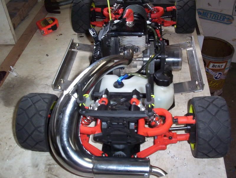

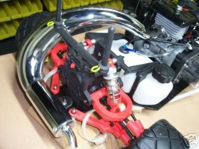

Yeah I printed out the picture already and am scribbling where I can put everything. The posts on the sides will be battery trays. Like the one this guy did.......PERFECT for 12S

I talked to a company today that sells them. They apparently are interested in selling me a roller.....so that is all I need. I'm going big on the motor though. I think just a single 1527 or 2215 minimum and then a SHV controller.

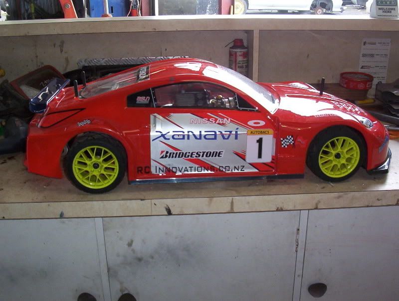

I was looking at this car....
Looks like a ton of room for batteries and ESC/Motor....
Yep, that's the one I'm talking about. I'm in contact with the factory that makes it. Hopefully they should send me one so I can convert for them.
Edit: I asked them to take out the engine, gas tank and those side gears.

Let me know if they work with you. This car looks like the PERFECT canidate for very high speed passes and the stock body looks to be perfect for 100+ mph passes. The car in general looks great for racing.....looks solid.
