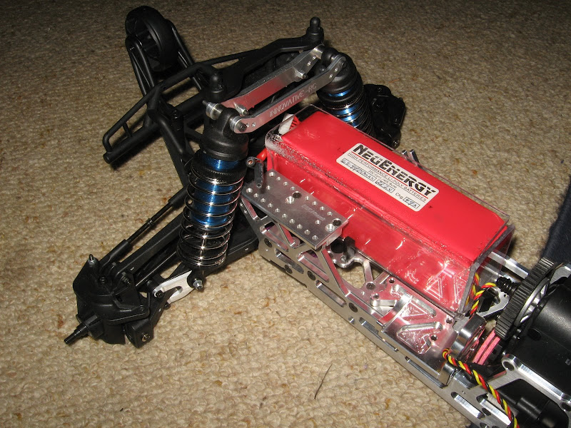

I got my battery so now all I need is my MM. Its supposed to arrive on Wednesday so hopefully I'll be up and running shortly.
My TrueRC pack. It barely fits in the space alloted by the FLM kit.
I decided on a 20 tooth pinion with a 49 tooth spur to start.
Heres the plexiglass to stop the battery from pushing forward. Its JB Welded to the FLM battery stop.
Heres the rear.
Plexiglass on the top too.
I put a groove in the Plexiglass to keep it from moving when I inevitably hit a mailbox.
Now all I need is my mamba max and I'll be all set.

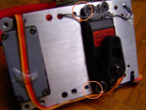

I stole your picture dpb318 to show this. The plate is thick enough and supported well enough that it doesn't flex except for these 2 little spots. I don't think it will be a problem though.
I didn't have to drill out any of the holes in the cross braces either like coolrunnings. Coolrunnings you may have just been unlucky as I know there were some mixups with the cross braces in this kit.

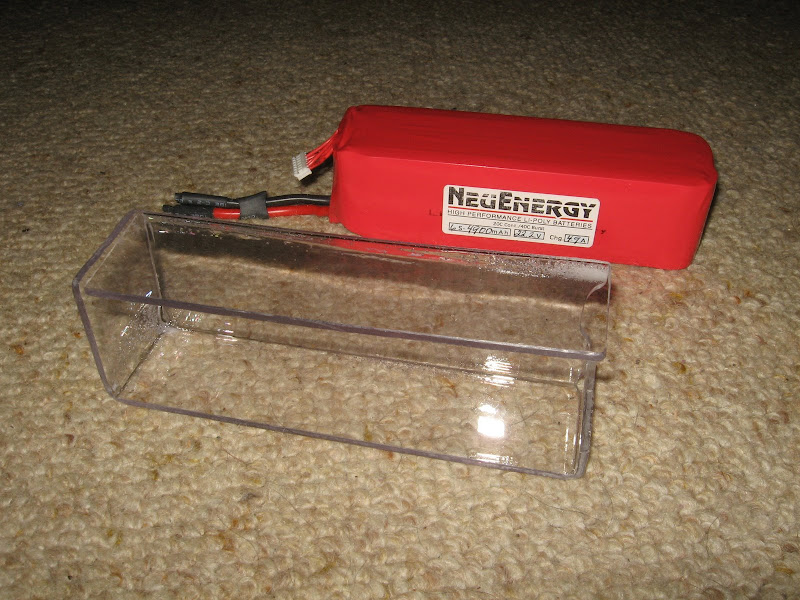

Your plexiglass cover is so much neater then my lexan cover.

thats good to hear about the servo plate flexing, hopefully itl be ok. your lexan cover is more protective than mine, mine isn't glued together as one piece and there isn't even a piece of lexan on the side with the motor as there isn't enough room
nice shocks btw

I have had to take to that case with a dremel to make it fit a bit better. As you say there really isn't much space on the motor side and I had to then the case to be able to mesh the motor properly.

i should make me a battery box like that for mine. What do you guys use to bend the lexan or plex glass? I know you just heat it up but what tool would be best for this you think?

i used plexiglass for the battery cover and i didnt bend it. the sides aren't attached to each other
Looking good BTW. I have a FP 5000mah 5s and a 1515 1y and i get over 30 min run times and that is hard driving.
I bought a $3 fence paling from the hardware store, cut it up and used some clamps and a heat gun. I bent the lexan around the fence paling because the fence paling had nicely rounded edges. If you get the bend wrong you just heat it back up and re-bend it.

A heat gun puts off enough heat? sorry for hi-jacking the thread just really curious cause i want a box like that.
I'm talking about the heat guns that look like a hair dryer. They put out plenty of heat, too much if you aren't careful. If you heat it too much the lexan will bubble which you can see I have done on mine in a few places.
