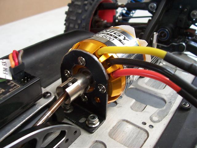

Hey i have an outrunner powered Duratrax Raze, i used a piece of 2inch angle aluminum on my car. I Talk to takedown almost daily... Sike, myself and Takedown know about these conversions if you need help
http://s152.photobucket.com/albums/s...t=100_0968.jpg
I used a 600kv 50-55 Turnigy Outrunner on 5s and a mamba max, im pushing 49 mph

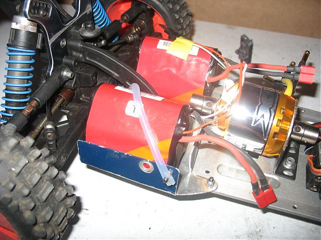

This is how my outrunner powered buggy looks atm, just needs an ESC

Glad you finally got it together RcMonkey. i remember building mine you were on my thread 24/7 asking questions. Good questions!! i enjoy answering good questions lol

I'm concerned with the thinkness of the motor mount, without the additional usage of a rear motor brace. In the past I had a mount of greater thickness bend with a Feigao 8L off of a small jump. The idea looks great, just needs more thickness IMO.
brushlessboy16
brushlessboy16's Avatar
06.22.2008, 05:03 PM
my 1/8th inch aluminum mount holds up fine..

06.23.2008, 01:14 AM
To me that material looks about 1/16", though.
06.23.2008, 03:47 AM
I see it flexing quite a bit too. Maybe he could triangulate it forward to the chassis with a link on each side?
I toyed with the idea of making a bracket that could support the other end of the outrunner, with a bearing around the shaft. That way it is bearing supported at each end, not just the mount end. I decided not to, but i am just running a smaller axi in the redcat, which is 10th scale. And my mount is reasonably thick 6061 t6 al.

06.23.2008, 10:13 AM
The mount is made from 2mm steel I found that was ready bent so there aint alot of flex I wanted to make a rear mount with one of the CD mounts but there isn't enough motor shaft showing to allow a bearing to run on the shaft as well as the drive cups.
