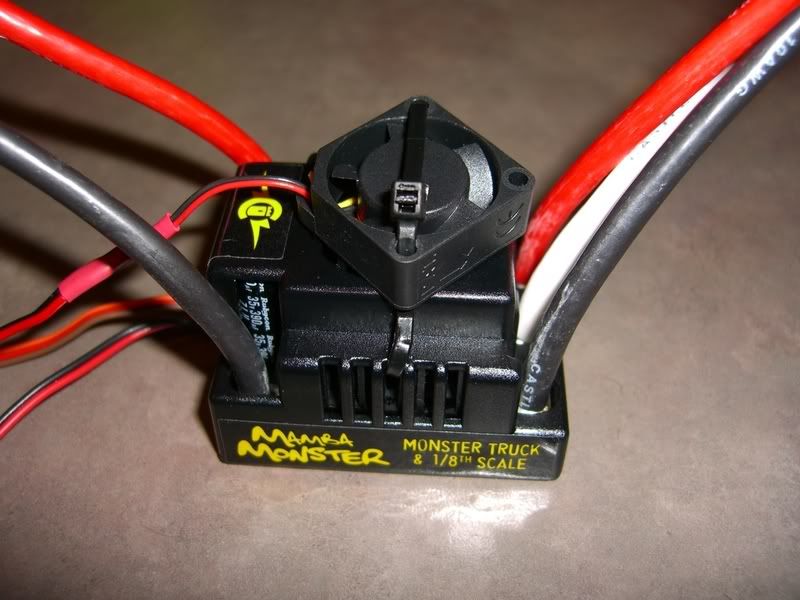

Heres a picture of the bulletproof 1/8 controller. Does this void the warrantee? Its the only way I can keep a fan on it.

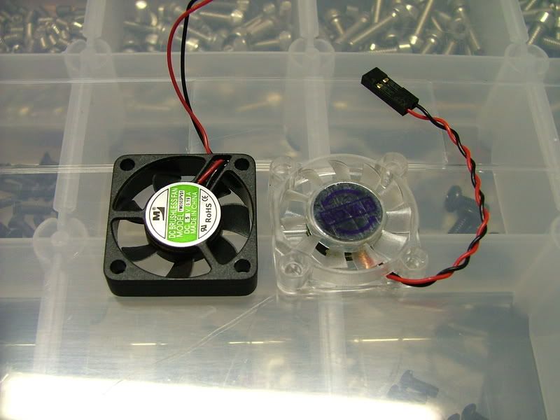

I found a fan that may work as a replacement if you don't want to get another from Castle or want to have a backup on hand. It's a Novak fan (those other guys) that measures 30x30x6. I measured the stock fan @ 30x30x7. Both take a 5v input. There's one at my LHS that I'll pick up and test fit to make sure.
And like Joe said, do not run it without a fan. Judging by the temps some of us have seen it's just not a good idea.

I did that last night, Yes the Novak 30X30 fan fits.

And that's the actual fan from the MMM.
Putting in a new fan is simple. Pop open the case, press the itty-bitty tab on the fan plug, pull plug out, remove ESC guts, and pop fan out. Reverse the order to install a new one.

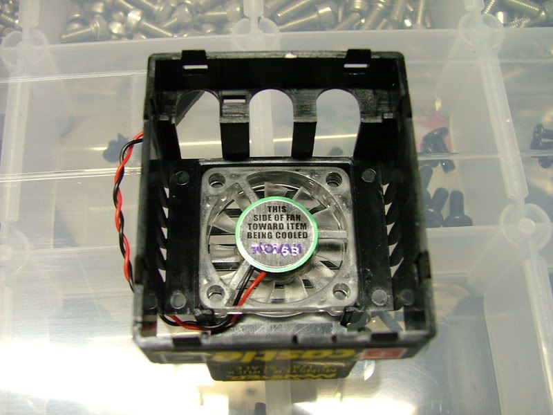

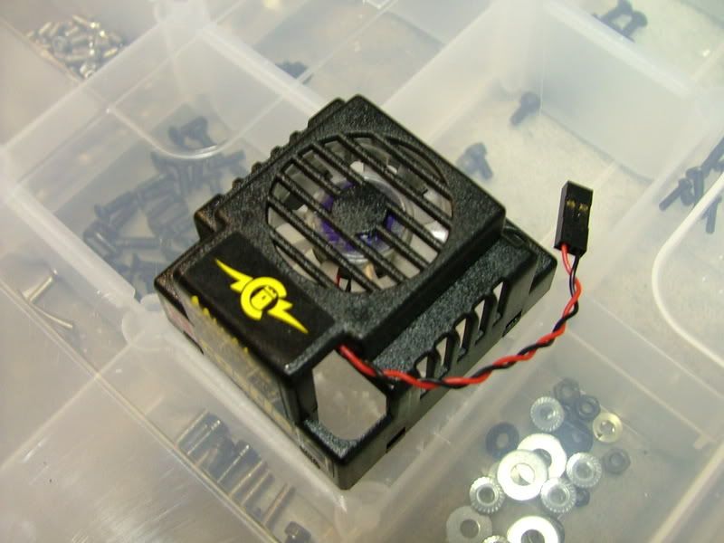

BrianG, I really don't understand your hatred (and it is a hatred!!) of fans. Placing a fan on a heatsink drops temps by 20-30F. Cooler is more efficient, correct? Why is this bad?
Pics of Novak fan installed. I'm not going to bother trying it out unless my Castle fan fails.
