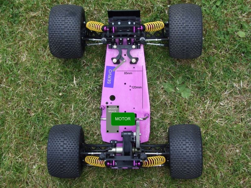

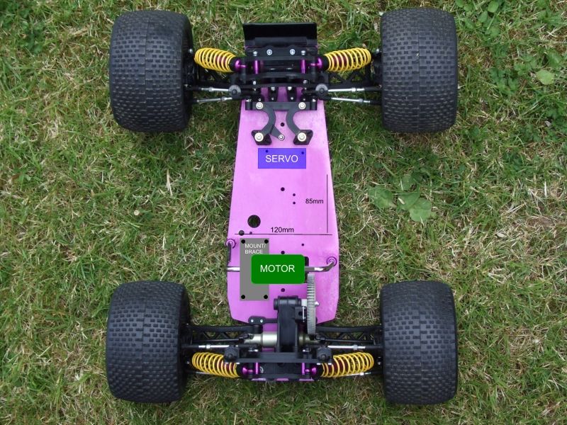

Thanks MetalMan, that'd be really helpful! I've whipped up some rough diagrams of the sort of space there is available on the chassis, though as you can see, there isn't much with either steering servo configuration, and I really don't want to go with 1P. I'm thinking 12 (or 14) cells are going to be pretty hard to cram on there, even when stacked; I can't come up with a decent config. Maybe you guys can! The other thing that concerns me is that, aren't A123 cells kinda difficult to solder? I've not used them before so I don't really know, but I've heard the aluminium can is tricky to solder to?

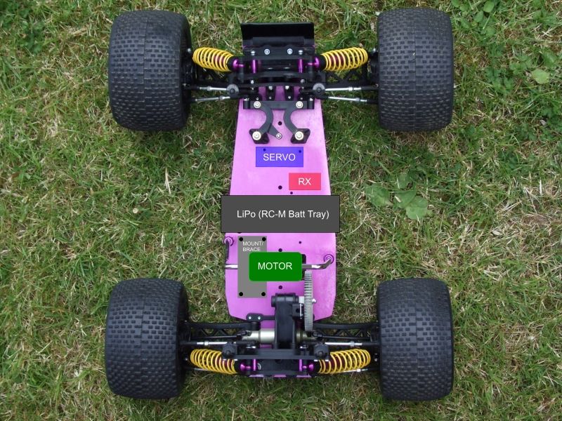

This is the LiPo layout that I was going to use, and I might do still:
I'd use the RC-M battery tray, with just one big 5 or 6S, 5000mah (or aroundabouts) LiPo strapped in as well as can be. It'd certainly fit better and give better output, but it's just getting it properly secured. I might do a lexan casing around it, *if* I go that route.

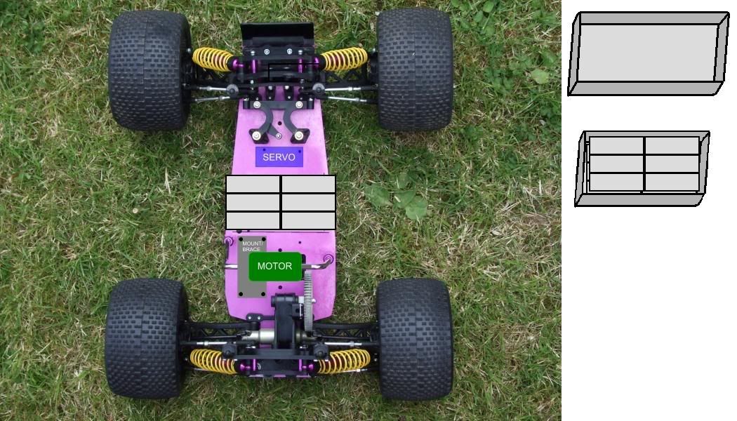

I came up with something I think would work based on your dimensions, but would probably required a battery tray like the one shown to the right. For material I was thinking 1/8" Lexan/polycarbonate, which is easy to cut and can be bent with a heat gun.

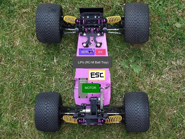

if you dont go A123 cell setup i would think the truck would handle a little better if the wieght was centered in the 2wd here is your picture just modded to show the esc and move the battery more to the center...just a thought. and it would keep your reciver as far away as possible from the motor and battery wires.

MetalMan, I think that configuration would actually fit! I hadn't thought of that setup, so thanks for the drawing. I've been thinking about it though, and it looks like it's gonna be pretty expensive after all to do a 6S2P setup with A123 cells after all. Obviously the DeWalt packs only come with 10 cells, so buying another complete pack (or even just two separate cells) would begin to work out to be kinda expensive. Also, wouldn't the spot-welded tabs strangle current output? I've not used A123 before, so I really don't know. If I went with 5S2P then I'd obviously lose quite a bit of top end, and a box-stock nitro Havoc is capable of 55mph...so I'm aiming for that kind of speed.
