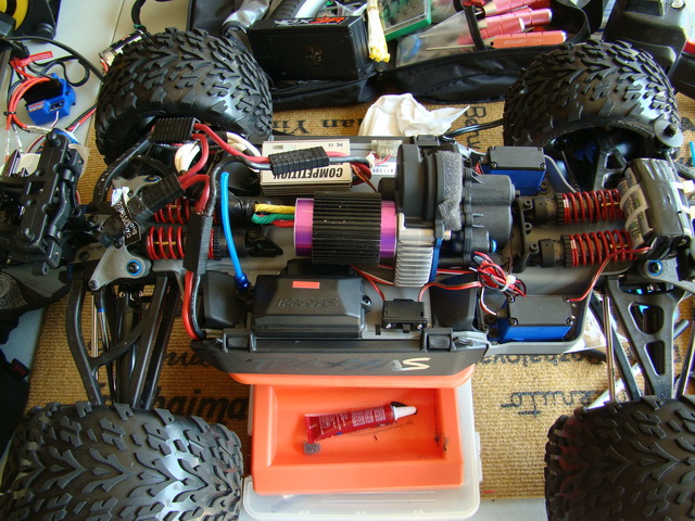

I got my Traxxas E-REVO two days ago.....Just removed the stock electronics and installed some components I had laying around the garage:
Feigao 9L Brushless motor
Quark 80B Brushless controller
I was planning for 5S Lipo and didn't have Battery Elim. Ckt. (BEC) so installed rcvr. pack
Spektrum SR3100 required "y" cable.
It was neat that Traxxas receiver had two inputs for steering servo. The SR3100 does not so I had to run to the hobby shop for a Y cable.
Just got it all programmed and ready! I'll post pictures later.

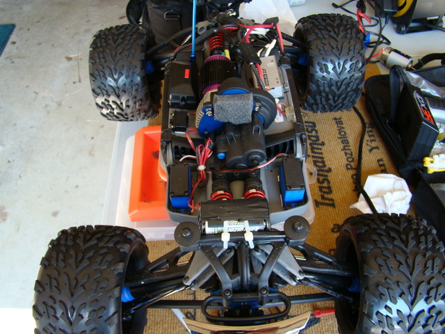

Ok Stum,
You showed us yours, now here's mine. I took the easy way out. I bought a Traxxas E-Revo and swapped out the electronics with some parts I had laying around. Here's a couple pix:

Stum,
According to the manual for the Quark 80 ESC that I used, the built-in battery eliminator circuit (BEC) only works up to 4S (14.8Volts). I am running 5S (18.2 Volts). To run 5S or 6S they recommend using an external Battery Eliminator Circuit, and cutting the red wire from the ESC to the receiver. Basically they are saying the built-in BEC can't guarantee a steady 6volts if you are feeding the ESC more than 14.8 volts.
Since I didn't have a BEC laying around and my hobby shop doesn't sell them, I used a receiver pack from an old TMaxx instead. I'll get a BEC after pay day.
