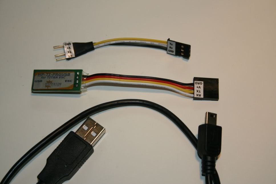

Anyone have a picture of the plugs/adapters all plugged into the charger? I am not sure if I got the right stuff. I got like 3 different things here.

These are the 3 pieces -
And here, they're connected to my 0606i -

Guys I am sorry but I have no idea how to update my Hyperion Duo. Is there anyone that can give me detailed instructions on how to do this? I have all the adapter plugs but sat down and tried to figure it out and just could not grasp it. I am running windows xp. I would really really like to update it. Any help? Thanks
Duster_360
07.20.2008, 12:27 PM
You need to print this out and read carefully. Its pretty much a step by step instruction on how to connect things and update the firmware. It was written for 1.5, but applies to 1.6 as well.
http://media.hyperion.hk/dn/pc/EOS0610iFIRMUP.pdf
Everything needed (software) can be found on hyperions site - look around forit, its plainly labeled. If you're uncomfortable doing this, ask the place where you bought your 0610i if they will do it for you (how much)? If you got it locally may not be a big deal, but if not, will require sending it in and waiting.
