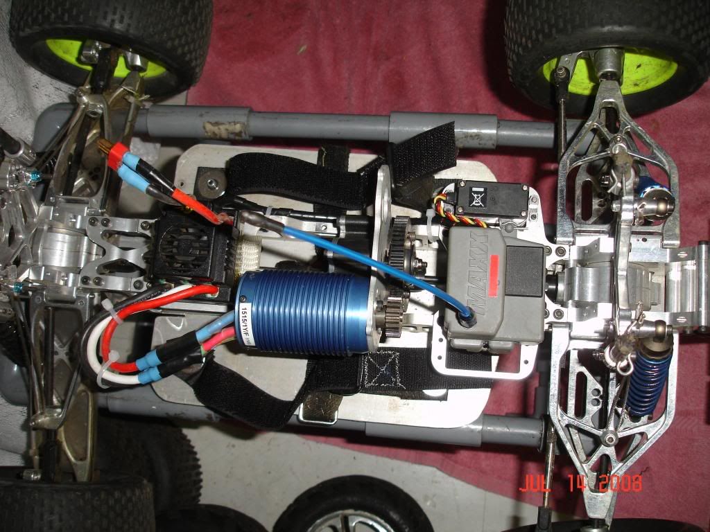

The 11,14,15 and 22 series motors all have 12 slot stators and 4 pole rotors. Have you thought about converting to single speed? I'm using a 3906 tranny converted to single speed using UE idler and gorillamaxx single speed conversion. So far, it has held up to the power of the 1515 1Y motor on 6S. I'm also using a strobe slipper with 51T spur on 20T pinion (both Mod 1). My diffs are UE 8 spyders on GA bulkheads.

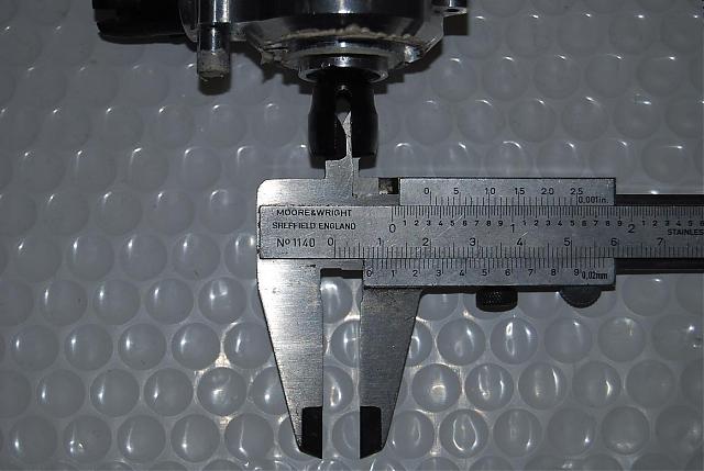

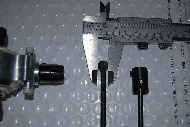

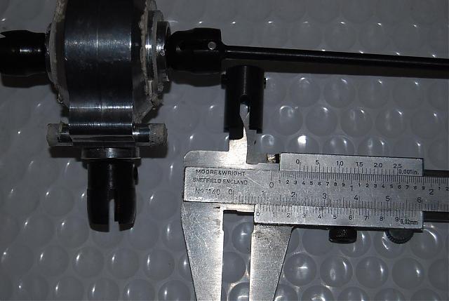

George, here a few pictures of what I meant about CVD's ball ends not matching up. Inner Diameter(ID) of the UE Spyder8 diff cups are nearly 8mm, Outer Diameter(OD) of the 3.3 CVDs are almost 9mm. Diffs to knuckle shafts.

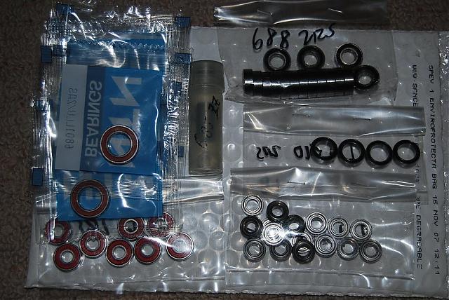

Also, bearings arrived, more than I probably ever need.
Getter Robo, I thought high carbon or high strenght steel are attracted to magnets? these doesn't. I could be wrong.

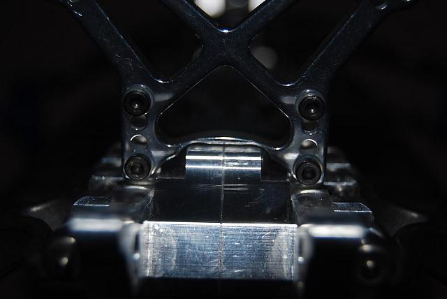

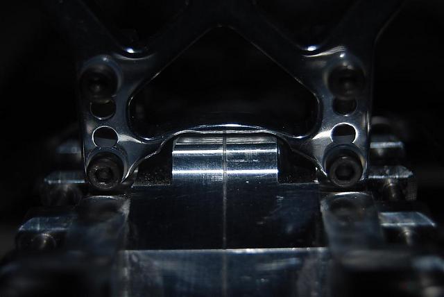

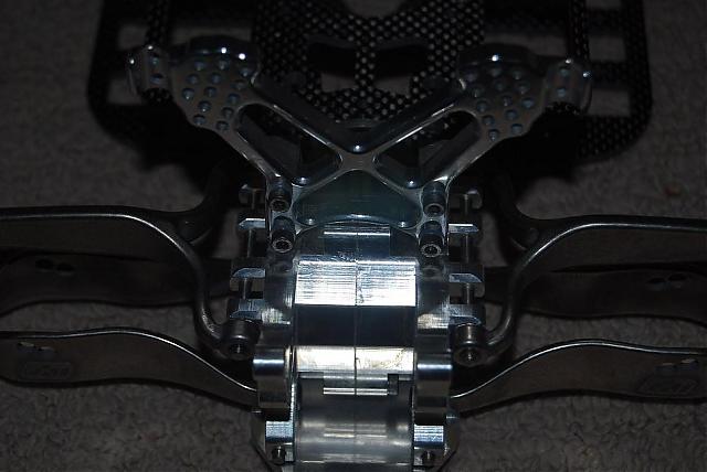

Finally got the shock mounts to fit onto the FLM hybrid bulks. Good to have a Dremel, also pictures of what I've done so far.

07.15.2008, 05:43 PM
Damn, you couldnt account for a bit of bad luck like that, but a dremel is a wonderful thing to own
Is it just me, or do trucks like this look better without the wheels on? Looks great so far.

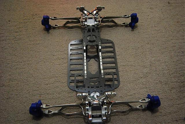

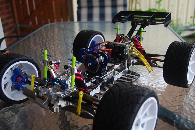

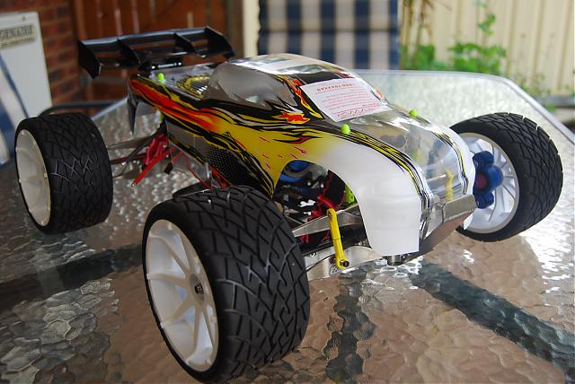

Well guys. Just an update on what i've got so far. Looks like Neil's truck. Well, I really liked his. What was I thinking when I plan to build this??.. one word..SPEED. (for an E-maxx that is).

Doesnt look anything like mine, lol. Has more in common with JohnyMaxxima's 70mph truck, especially with the flextek, CF chassis and phaltlines. What swaybar kit is that, looks interesting?..

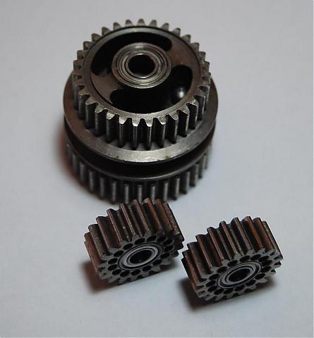

any ideas where i can get some of these gears from i have one set that i got off ebay but i have another transmision i need to make bullet proof
Originally Posted by MaxxFreak View Post
NIce truck George. Yes, I'm ordering that Gorillamaxx single speed convertion and a single motor mount. I have a set of Ti gears and idler I bought from some wanker of ebay, told me it was new, came with lots of dirt and oil. I missed out on the bid for the strobe slipper. Already got the RRP slipper. I'm having problems with trying to put 3.3 CVDs with RPM Revo alxe carriers, Flextek Ti arms with FLM hybrids UE spyder 8 diff together. 3.3 CVD's ball ends are 9mm OD and UE diff cups are 8mm ID, also the shafts are too short. Someone here said UE CVDs are longer, but I'm trying to figure out some other way of doing it, extending my CVDs. I'm also getting the 1/8 diff output shaft from Mike. Hopefully with those and the cups that came with the CVDs will bring it out further. Supermaxx Shock mounts and FLM hybrids don't mix well. Have to file quite a bit on the shock mounts to fit. Will post some photos tomorrow.
  (#30)
08.01.2008, 01:29 PM
If our old 'friend' isnt selling any on ebay at the moment, then RC4WD.com sell a full set of aluminum gears for about $70 I think, they should be pretty solid. You could always use the RCM steel idlers with those alloy gears to be 100% certain the tranny is solid.
