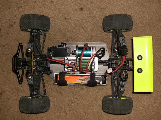

Well I finally have a working computer again so now I can put up a pic of my build. I purchased a roller from CCristo with RCM motor mount to start with. I decided I wanted the extended chassis so I found a new OFNA extended kit on ebay. Using a MM esc and a Medusa 36-50-4800 motor running on 2S 6000mah MaxAmp packs. I built my own battery tray out of some alluminum as well as a plate to mount the esc and spektrum receiver abobe the center diff. I'm using a spektrum high torque servo fro the steering. The picture shows the truggy with the stock bowties but for general bashing I picked up a set of traxxas slash tires, untill I can find someplace that has the bandit anacondas in stock. This truck is absolutely amazing!
