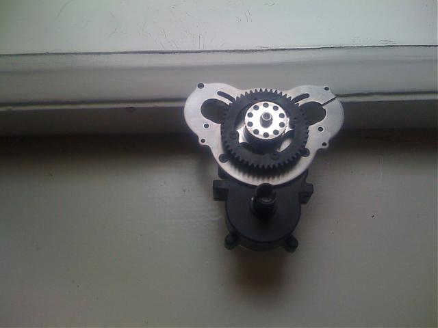

I opened the gearbox
It seems that the Hardened Idler is there? Should there be grease inside?

Looks great - That should work great - Yes there should be a V light coating of grease Honda Moly 60 works well.

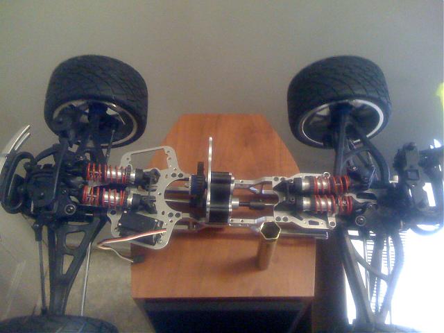

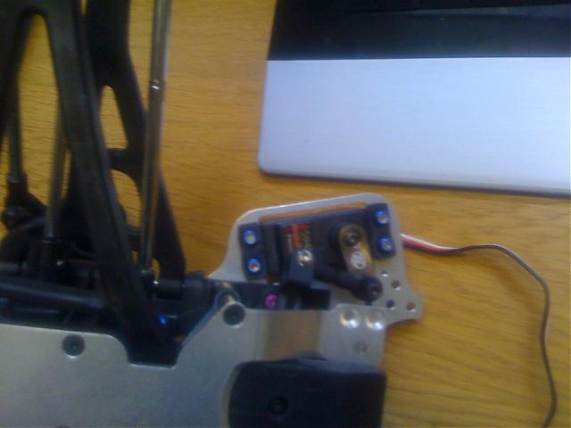

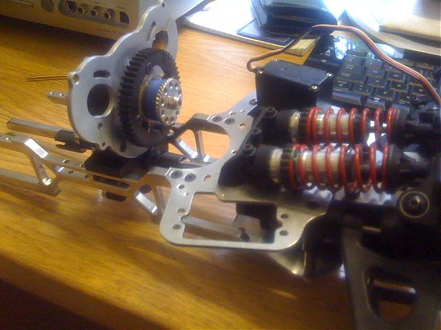

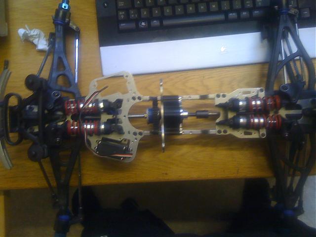

Little update. Mike lost all my emails so the order did delayed a little bit . It happens, but I think he can get the stuff coming in a few days..
I did some preliminary work and turned around the gear box, installed front/rear bumbers, put the servo in place and loctited all the metal to metal screws. Also I ordered new Spektrum Dx3r radios should be here in couple days.. Cant wait
Can anybody say about the motor, should I consider 10xl beside 9xl?
Here some crappy pics:
